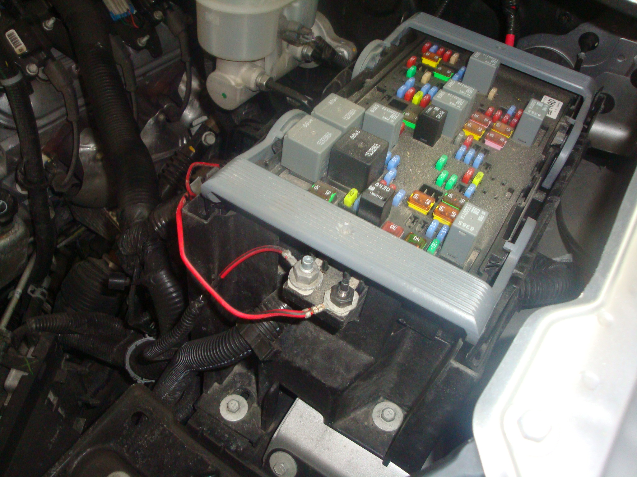

Got my Recon Xtreme Lightbar today. ( after a 5 month Back Order ) Their directions were not so good. I followed them and nothing happened. I mounted the bar, connected the white reverse light, plugged in the flat connector to the load resistor box they sent with the bar, and then plugged that into the truck connector. I connected the red wire to the red wire in the trailer harness. From what I am reading do I need to hook up that wire under the hood ? Or is there another wire I splice into ? Your help would be appreciated..
Bigblue said :
Use the wire taped to the bundle below the brake master cylinder and run it up to the smaller of the two studs on the front of the under-hood fuse block. Install a 40 amp j-case fuse an it's ready to send 12 volts back to the trailer connector.
see the attached picture. You need to hook up the existing red wire (AND ADD A 40 AMP FUSE) under the hood.
