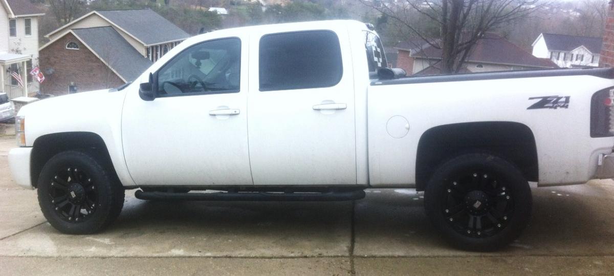

I have a 2011 Silverado LTZ Crew Cab with a MagnaFlow Exhaust and a KN Filter replacement. Not a lot of performance mods. I have a leveling kit, and (will have20" wheels and 33 tires.) Im wondering what are the pros/cons of these two mods, and the average cost of each. Ive done research on the re gear and im wondering if it will help much for just a daily driver. I dont do any off roading and it looks like thats the main reason people do the regear. Id like to have more power w/o sacrificing fuel economy. I didnt know if these details would change whether or not id get a regear. Thanks in advance for all your help. Im not a mechanic obviously so i appreciate basic or logical explanations! lol
Will be posting pics tonight of the Black 20" monsters with 33" Wild Peak tires on the white silvy!

Im actually not sure which gears i have. Ill find out when i get home. Its a 2011 Silverado Crew LTZ Z71 5.3L. I test drove the 6.2 and it was a beast and only 1K more. Kinda wish i woulda bought it, but the 5.3 was enough to make me happy and liked the gas mileage. But i want some more power. If i could go back i might get the 6.2 instead, oh well.
