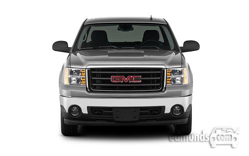

2500HD grill on 1500
TRUE!
No it will not fit, The 2500 grill sets lower in the front bumper
The grille is longer to fill in the space between the grille and bumper because the 2500
frame is almost 2 inches taller than a 1500 frame.
