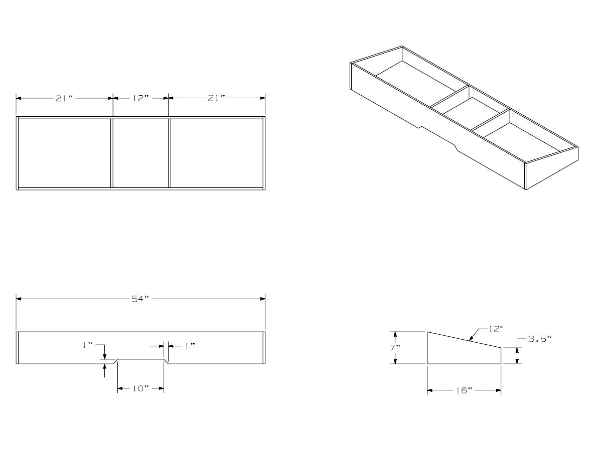

Took some measurements from my truck over the weekend. Threw a drawing together for reference. Hopefully I'll have some time to build it soon. Plan on using pine and then covering it with black speaker box carpet.

Holy old thread Batman! Exactly what I was looking for... Might Dr it up a bit and possibly add a bottom ( seal with some sort of apoxy/paint or something to prevent spillage of anything like grease ) but I know I can do better than that cheap 160$ piece of plastic for half the price
I did mine last summer. I used cardboard to make templates and then transfered them to wood. I cut them to the contours of the floor board so it sits nice and snug. Then I covered it with black automotive carpet to match my interior. The carpet is only $10 for enough to do the whole project.

Nice stuff guys! I found some tool bags (duffle) at Menards that fit perfectly under the seat. Originally I didn't think about making an organizer since the inspiration came from the Rubbermaid bins that go all the way across the floor. With the 60/40 (70/30 or whatever they call it) back seat, I really like that I can flip the passenger up for buckets of stuff or other tools if I need to.
Now the thought of building a box that goes from the drivers side through the middle and leaving the passenger open comes to mind (or making it modular so the passenger side can be taken out).... Now I just need the time. Hmmmm....
