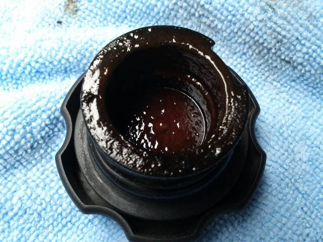

Is this coolant in my oil?
I know I have a leak. Pulled off the oil cap and this is what I see on the underside.
Is this indicative of a coolant leak in the oil?
Time for a dye test
Sent from my ADR6400L using Tapatalk 2
When my heads were leaking coolant it was more of a bright orange color. Sort of like the fungi you find growing on some dead trees.
Might be coolant hope that it is not. My previous truck had the castech heads and the coolant and oil would get all over my oil fill cap, it was more of a yellow brown color kind of like a thick mucus. If you are loosing a lot of coolant and can't find a leak, that is probably coolant.

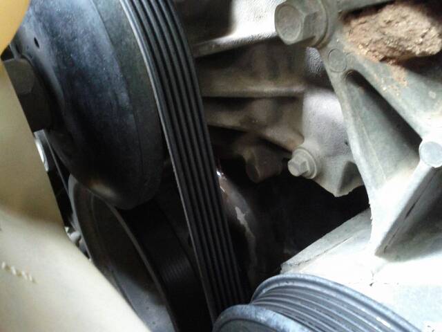

Alright, Just finished the pressure test and found the what I think is the leaking culprit.
This looks like the water pump, doesn't it?
The leak can be seen actually dripping, in the first picture, a little more than half of the way down the belt on the right. Where it is dark, obviously it is wet.. Light its dry. this is immediately behind the fan.
in the picture with the fan, you can see where it is wet as well.
The truck is inn my driveway that leans ever so slightly from left to right, passenger to drivers side. I believe the coolant is following gravity and shows as dripping a little further towards the drivers side than the actual leak is.
What do you think?
Good to know. Thank you for getting back to me on this one...
I will order one today, is AC Delco OEM? Should I replace the thermostat at the same time?
