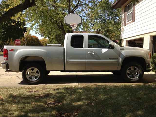

After the leveling, finally added 3" blocks and what was I waiting
Hmmm Interesting....What is needed for this mod?
I have the 2" rough country leveling kit and thn I ordered 3" rough country blocks. That's all... And an alignment of course

I have 2 inch blocks and ccm 2.5... with a full tank of gas there isnt n e noticeable rake. Looks like a truck should. But when i put the 4wheeler n the back and pull a trailer it sags. So if i was towi.g more often i would gave went with bigger blocks

The rake with the 3" blocks is perfect. I have the RC 2" with 3" blocks on both of my trucks and love the look. There is nothing worse than adding 2.5" to the front and nothing to the read. That front end higher than the rear looks terrible and will be much worse when towing or loaded. Some seem to like the dragging a** look for some reason. IMO the truck should sit level when loaded, that's why there is rake on them.

I added an add a leaf to my truck. whats the next size block up from stock. i want to add a little more to the back
