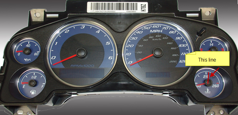

based on what doug was saying it wasnt overheating....
my needle was about half way thru the zero on the 100 reading (210)
i'll try the ac to see if my fans work
That's normal on these things nowadays - 210° is straight up at 12 o'clock on the gauge - perfectly normal.
Well then yours runs cooler than mine. Ever since mine left the lot, it runs right up to 210° and stays there, unless I'm towing over 5,000 lbs. up a long grade, A/C on, on a 90°+ day - in that case it will pass 210° until I crest the hill.
but.. mine is to the right of center, goes thru the middle of the '0' digit.. and that's at idle with no AC on
i attached a drawing... trying to show what i mean.
AHH ... I gotcha now. That's the problem with internet diagnosis! :)
To the right of 210° is hot - so if it's only happening at idle, then it should be a fan issue.
If it's not puking coolant out I wouldn't worry about it ... unless it's getting close to 260°. Factory gauges aren't noted for their superb accuracy. A scan tool will tell you what the sensor is reading, but I'd rather use an infared thermometer on the t-stat housing, or a cylinder head to know for sure.
