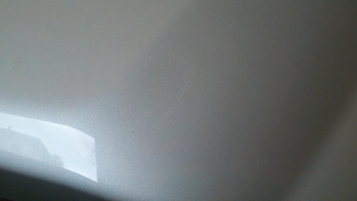

Found under the paint on new Avalanche
Look what I found under the paint on the hood of my new Avalanche. It is about 3/4" by 1" rectangle where the base coat laid funny. The top coat is smooth as glass. I suppose I could ask them to repaint my hood, but I have the white diamond tricoat ($995 option) and I doubt they would be able to match it very well...

That much of an option would make me have them repaint even more. If they cant match, tell em to repaint whole truck. Don't settle on a prep flaw or paint fail.

I am an auto insurance appraiser by trade... Have been for 13 years. Being a tri-coat paint, they could repaint the hood, but would definitely have to blend the fenders for color match. Just my $0.02

I wouldn't accept this flaw. Have them fix it...they can do wonders with matching the paint nowadays. Especially on a brand new vehicle without faded or sunbleached paint yet.

It dosen't look good but if its anywhere on your truck that is the best place , way better than having something on the side to repair with the Tri coat
I'm currently doing a white Tri coat on a Nissan tomorrow morning . If done correctly they can look unnoticeable . The first step for me is to spray up a test card with the ground coat then taping up a section of the card, spraying on the mid coat one coat then moving the paper up the card to revel more of the card doing this again and again till you have about 8 sections on the card sprayed , clear it and see which one of the sections is the match for the paint on the car being painted . Its usually in the 4-5 coat range of the test card . Then you just repeat this to the car or truck

exactly... we had a guy bring us in a New Cad that the dealer had done ... needless to say its wasn't very good . He wanted us to do it but only do one panel and thats not possible with Tri coat ,thats not a reality to make it look good .
Looks like someone touched the hood with a greasy thumb and it reacted. Any top notch paint shop can fix you up. They will deffinatly have to paint the fenders as well to make it match. The problem is now you have adheasion problems so if you decide to "live with it" it will possible flake off in the future. Take care of your investment and make them fix it.

Maybe I should have a forensic guy lift the print and find the guilty party at the GM paint shop!
