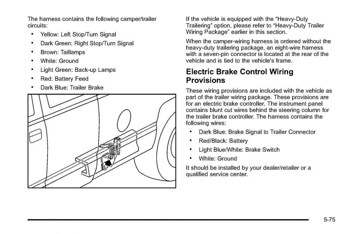

Trying to wire a Brake Controller....pull down the Harness....Thank You for the 8 inches of Wiring.....tag does not show what color wire for Brakes.....I figured it's gotta be Dark Blue by elimination (has "AUX" on it), but want to be sure....call GM customer Service....they don't know, and will call me back with an answer.....10 minutes go by and have a Tech from GM on the phone, and he explains to me how to sinc my camper to the 7 pin......"WTF you talkin' about....I need to wire a Brake Controller !!!"......"I need to know if the Dark Blue Wire from the Harness is for the Brakes"....he sez "I don't know, and cannot get that information".....WTF !!!!!!.....I'm hating this POS truck more than ever now.....they cheap out on the wire.....then there is no nut to attach the red wire under the hood.....gimme a freakin' break !!!.....I can't wait till this lease is up! :rant:

According to my owner's manual the colours are as follows
Dark Blue - brake signal to trailer
Red/Black - Battery
Light Blue/White - Brake switch
White - Ground
See the attachment for the actual page. I am sure your manual has it as well.

What's an owners manual?
:lol:

Great reading material :)

Yeah....go ahead and laugh, I looked for it in the owners manual, and didn't find it the first time around....found it after realizing customer service was a waste of time. Just don't understand why they couldn't have the tag on the wire read accurate, have such a short lead, and why not stick with a plug and play like my 2006 Silverado....this Silverado makes 6 that I have owned, and this one by far the one that I just can't stand.....don't like the way it rides....the 6 speed tranny always looking to upshift, and ya gotta nail it to go from 60mph to 70mph....my '06 was just a little squeeze on the gas and she'd get there....this thing, I squeeze on it little by little....not going anywhere, now I'm holding up traffic and gotta hit it hard...then it's downshift and off we go. Guess I gotta get used to it, signed up for 3 years.....on the 35th month, I'm beating the dog snot out of it while it's still under warranty.
