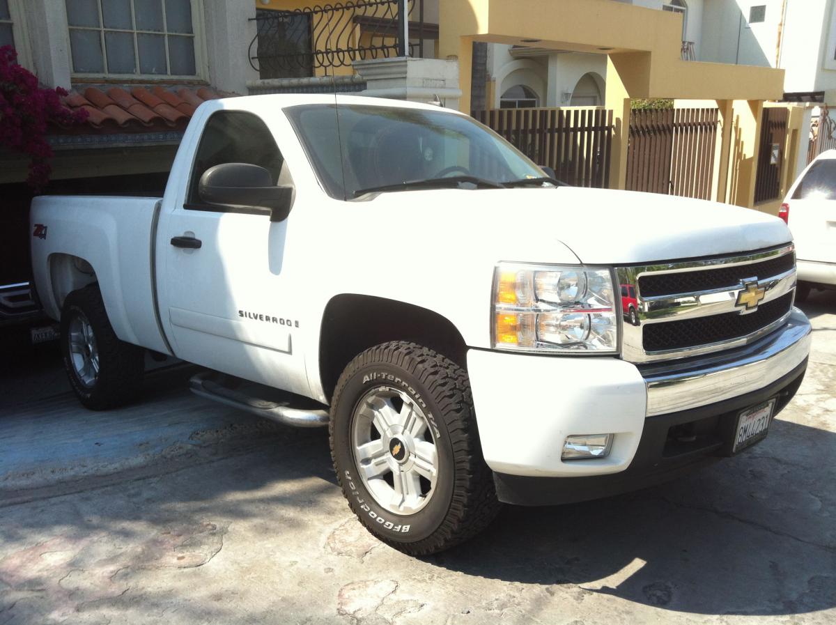

I have a stock 2007 Silverado 4x4 LT with a 5.3l FlexFuel that I purchased new.
Six years and 65K miles later, it's not the young whipper-snapper it used to be, but I've been good about proper maintenance, and it shows. No CELs, all original paint, no issues whatsoever.
Except after six years I feel like it's a bit sluggish, with considerably less power than I remember it having when it was new.
I looked in the owner's manual for a maintenance schedule or something similar, but was unable to find anything.
What would be the recommended items to service at 65K miles/6 years?
