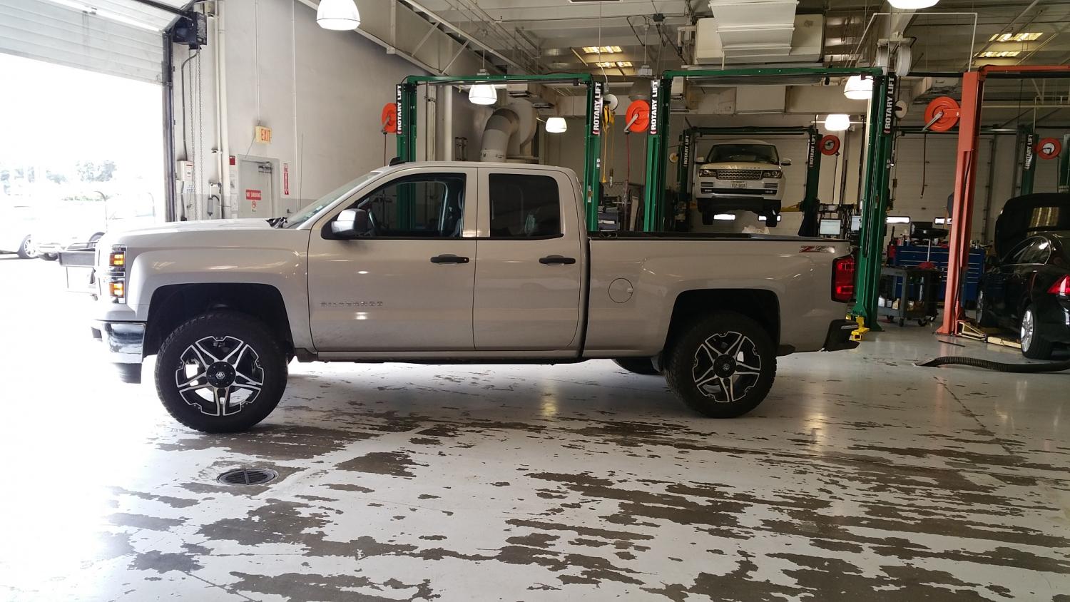

Ok so here's before n after pics.
Before: Stock height front = 36.5", Rear = 38.25"
After: 2" RC level front = 38.75", 2" Ready Lift blocks rear = 40.75"
& BFG AT KO2's (275/70x18). Truck now sits approx 3.5" higher. I like it.

Ok so I measured front center hub to rear center hub. Here's what I got.
Passenger side = 143"
Driver side = 144"
Definitely a difference. And here's a copy of my 4 wheel alignment report.
So now what? Seems off by a degree?

I'm stumped dude. :dunno: Did the alignment shop offer any advice? At least your truck looks really good, lol
