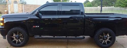

Since they two sizes are basically the same height, is it just the width of the 295's that would prevent me from running them on just a 2.5" level? If i decided to go with the 4" lift, would i have any trouble with the 295/60's?
Traded my silver 2014 with 2.5rc and 295/60/20 for a red 2015. 2.5rc and 285/65/20 bfg ko2
Man, both of those set ups look great! Did you have any problems with either of them as far as rubbing or trimming, more specifically with the 295's?
The 295's rubbed finder liners and control arms. That is why I went to the 285 on this truck. I did zip tie the finder liners back and they don't rub at all.
