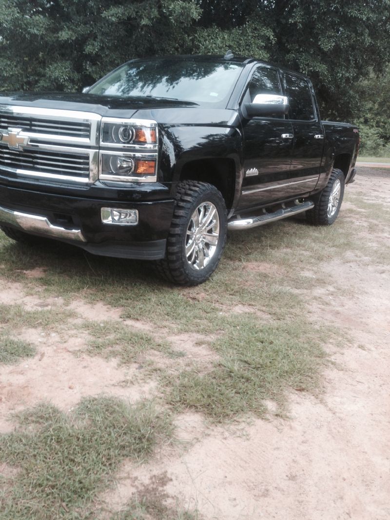

I would expect either of those sizes on a 10" wide wheel with a negative offset is going to require both a 2.5" level and the 1.5" body lift to not rub. And it's going to be close. The width and negative offset work against you, not with you, to avoid rubbing.

Phone pic of my 2014 High Country with 2.5 RC level and 12.50/33/20 Federal Couragia MT
