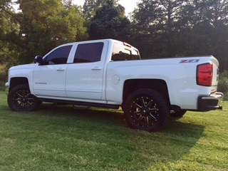

Over the last month I have been "building" my truck. I read EVERY post on this thread. Thanks folks! RCX 2.5" front level only, 20" fuel Mavericks +1 off set, Toyo Open country ATII
What size tires are those? It looks great!
Any pics down the side? Would love to see how much the tires do or don't stick out with that offset. Deciding between a 0 offset or +18 offset rim
