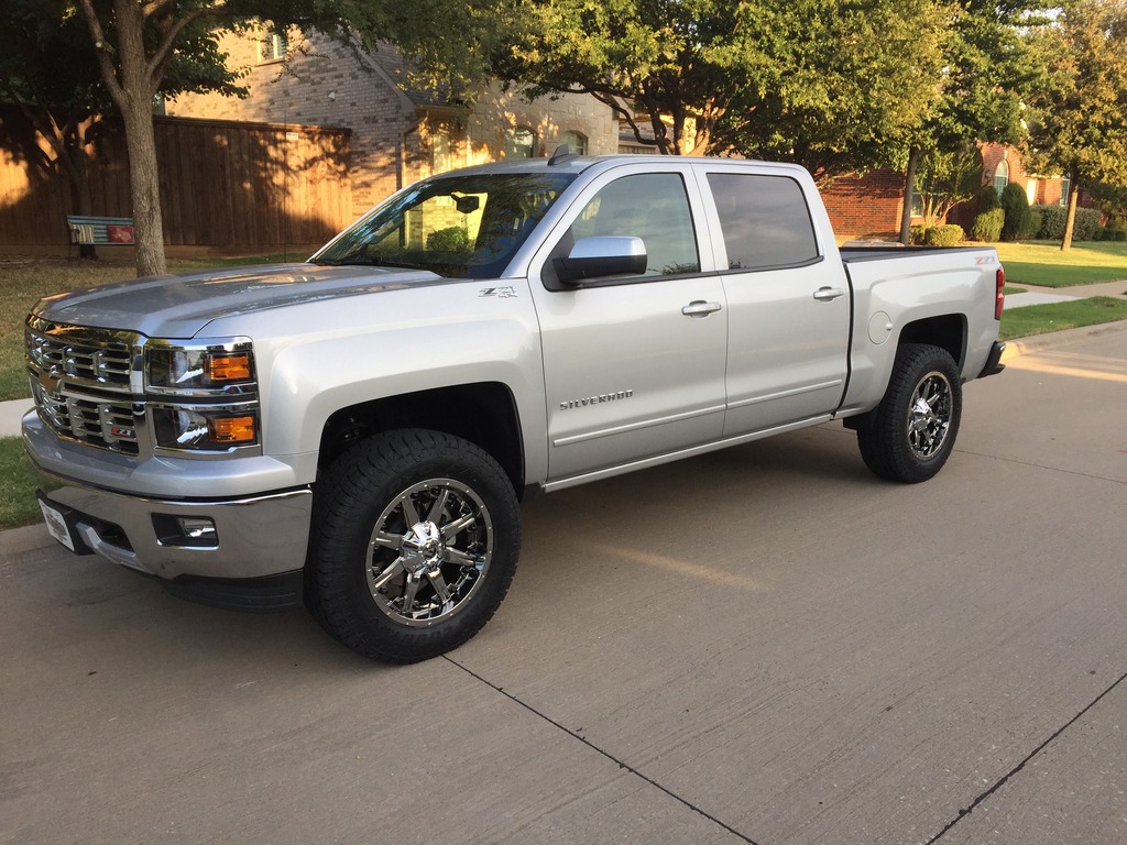

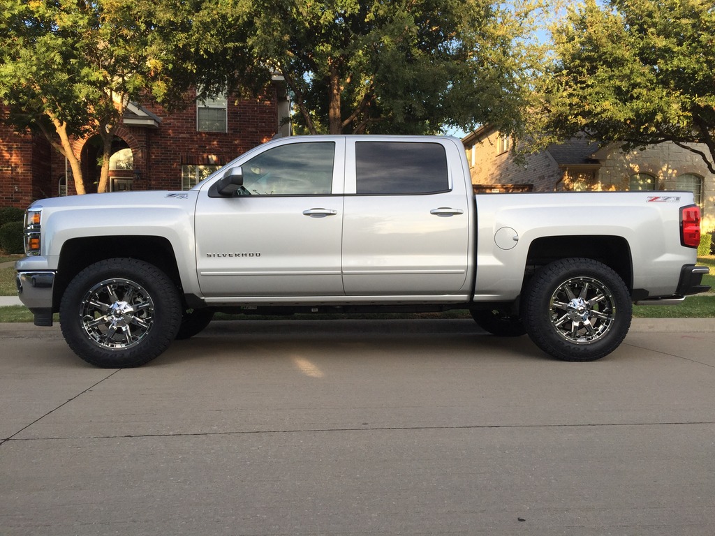

Finally finished all the mods, here is some info for those looking for it.
- 2inch rough country leveling kit
- 305/55/20 Nitto Terra Grappler G2
- 20 inch Fuel Maverick Wheels with a 20mm Offset
And before any one asks, No rubbing on the fender lining and suspension at full lock. I also didn't trim a thing.
Nice looking truck! That's pretty much the exact same set up i'm looking to run. Any chance you could upload some more pics? Maybe one down the side, or from the front showing the stance? Thanks!
