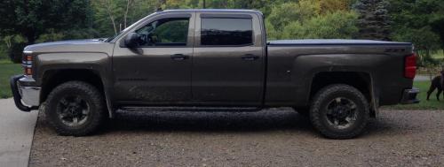

Rc leveling kit, 285/70/17 Mastercraft Courser mxt tires on rockstar II's, westin contour bull bar, iron cross step bars without steps on. Sorry its muddy.
