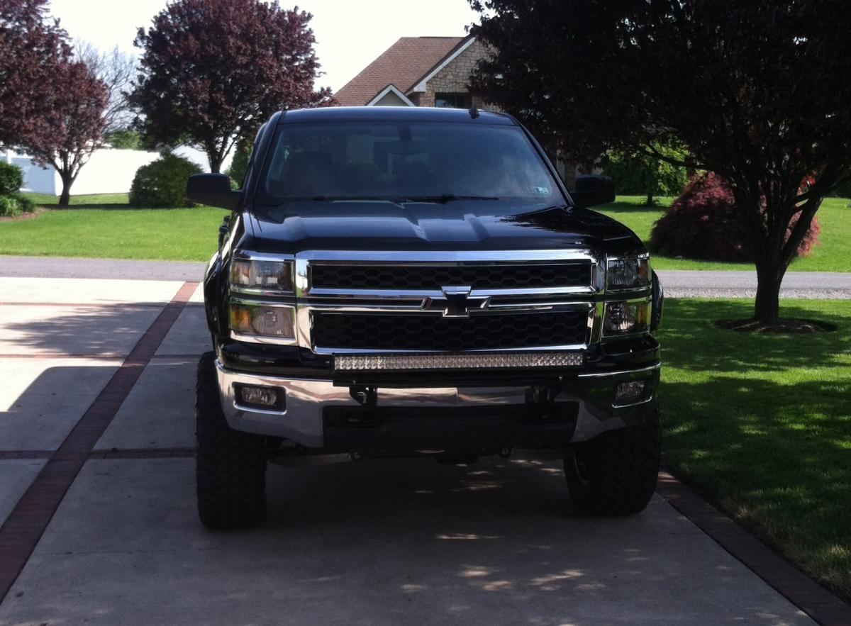

Looks really clean can you share mounting pictures of the lights?
Sent from my iPad using Tapatalk HD
the best way to describe how I mounted this is by taking the slotted pivot bracket off (comes un attached in box)
then the rotate the piece with the bolts going thru it 90 deg so that the bolts are perpendicular to the light instead of parallel.
I then purchased longer blots, drill matching holes in the top center of the tow hitch plastic cover and tighten. as you do so the light will start rotating (its starts pointing slightly down)
