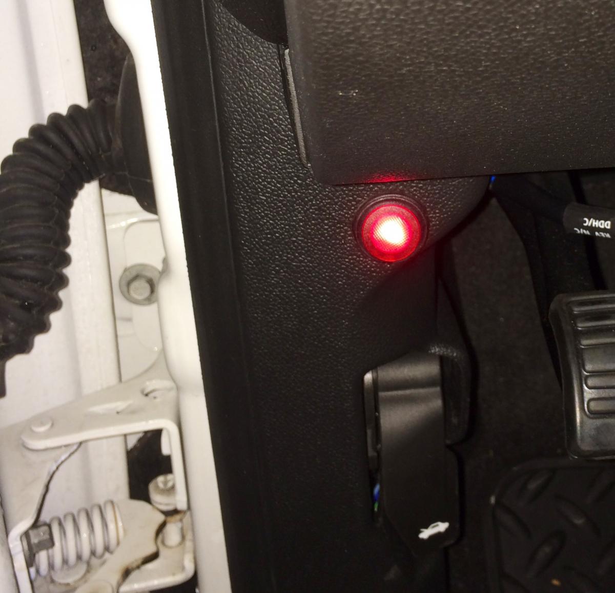

What is everyone doing for switch location? I removed the cigerette light plug and plan on putting toggles or push buttons in their place - just curious what everyone else is doing for LEDs
Sent from my iPad using Tapatalk HD
I put mine on the kick panel

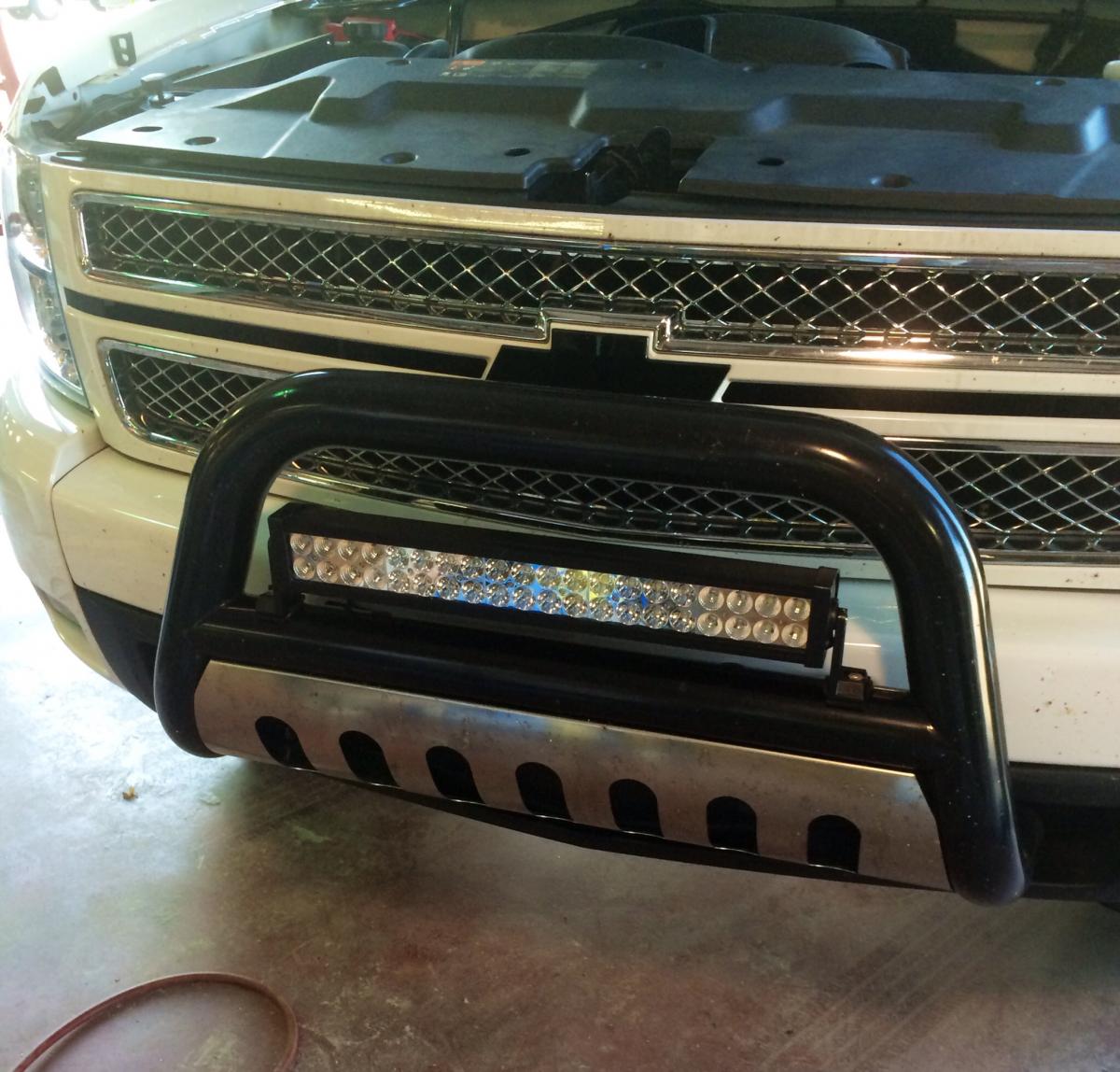

I have a 2013 and mounted a 20" on my bull bar

I'm getting ready to do that! What brand light bar is that? I won't be using it an extreme amount, so it'll be mostly for looks, no pun intended. So I'm just going with a simple 24" light bar I found on eBay. 2 year warranty, 12,000 lumens, 10A draw. Best part: $80

Do you already have the bar, cause you need to make sure you have enough space in the middle because mine has l think 22" in the middle and with the mounting brackets my 20" light becomes 21.5" so you need to make sure you have room for everything before you order it. I got my light off of Amazon for $90, can't afford a $500 rigid light with a daughter driving, but it worked the first day and continues to work and puts off a pretty good amount of light. I would recommend buying a wiring harness, I got one on Amazon for $35 shipped, it's from rigid industries and it has the relay and power and ground hookups and even a switch all I had to do was clip the end off because it comes with a plug for a rigid light and splice mine in.
