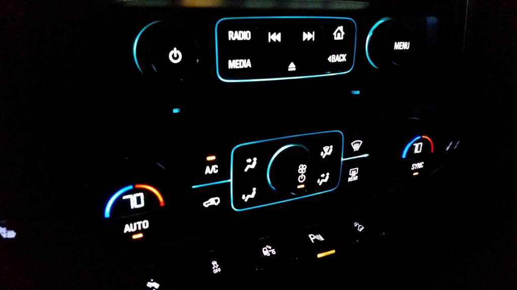

Glad they did the right thing in you're case. The LED's really make a big difference in how the stack appears.
The difference in appearance at night is far more than one would imagine with the addition of the 3 rings. It's like an entirely new console/center stack that looks great!
