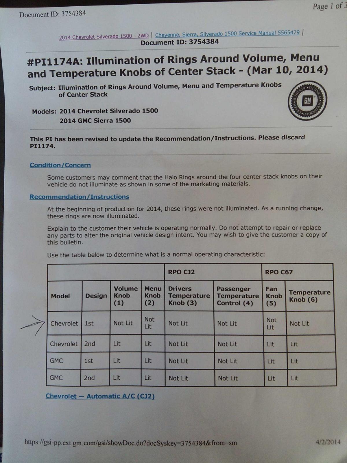

Here is a copy of the new updated bulletin regarding the LED lighting around radio/HVAC knobs. My dealer refuses to fix it. Even though I have a case with GM for seat and HVAC issues that have not been rectified. Customer service has been horrible.

The reason my dealer service guy fixed my non illuminating lights was that I showed him the brochure. He used that as ammunition to the regional guy to justify fixing them for customer satisfaction. Later on, through various communications with customer service and the regional guy, they finally said it was by design to not have lights and then later they made a runnung change to turn them on. Seems pretty fishy to me. IMO, they most likely had a vender who built them wrong; they just don't want to admit it. This way they are not obligated to fix all of them. After several months of asking about this, they come out with a statement. Hmm. Seems fishy to me. But then again, this is just my opinion.
The official answer is that Chevrolet Silverado trucks were built that way on purpuse and later a runnung change was put in. Meanwhile, all Sierra trucks had them illuminated from the beginning. Oh, and you asked about the picture in the brochures? Well, the brochure and guides were just marketing mock ups.
