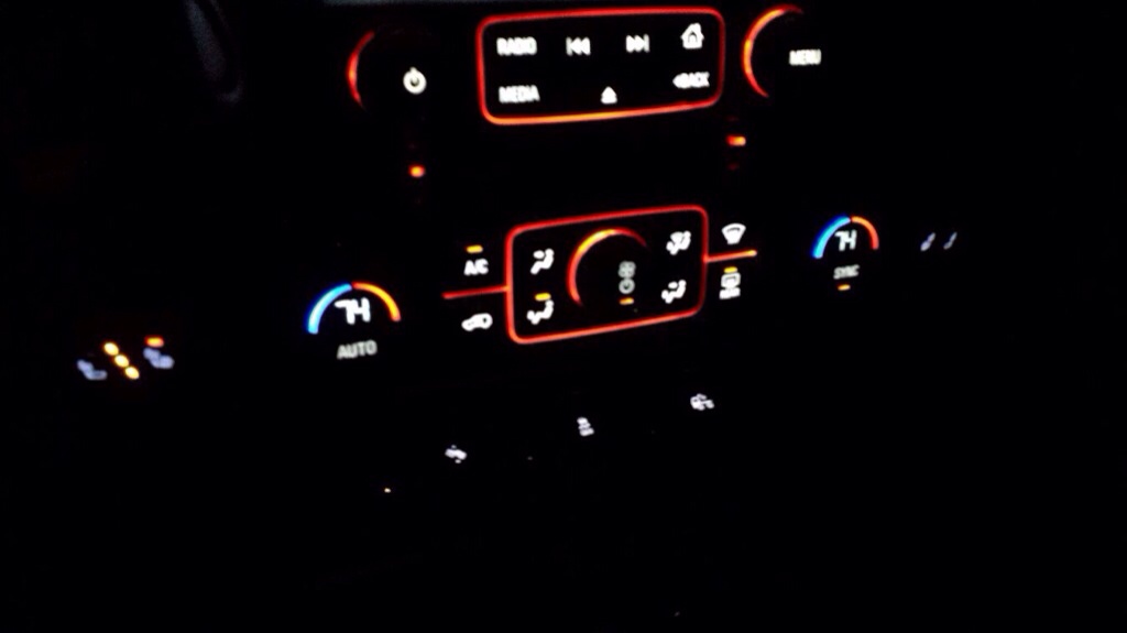

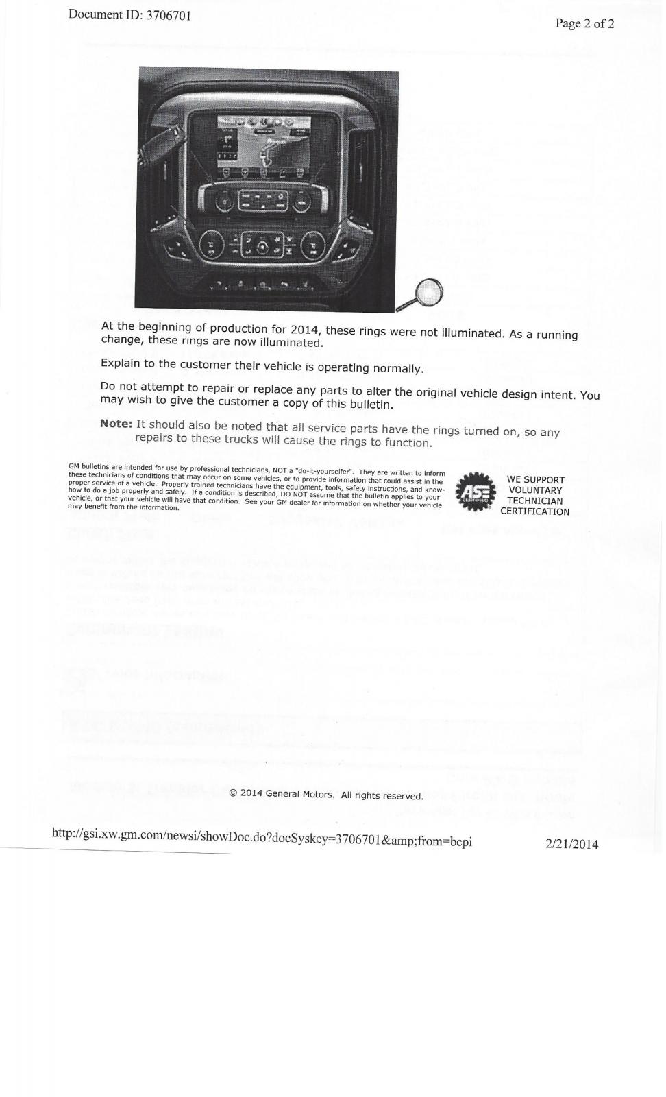

The picture I posted was an example of a non dual climate truck, so there is no center knob. All five radio/ climate knobs in the Sierras and Silverados are supposed to be illuminated. Please see attached bulletin as to the direction of 2014 build vehicles. post-128264-0-64721000-1393371062_thumb.jpg

Nope just the two radio knobs and the center HVAC knob..
The picture I posted was an example of a non dual climate truck, so there is no center knob. All five radio/ climate knobs are supposed in the Sierras and Silverados are supposed to be illuminated.
Interesting. I think that is the first example that I've seen that had those two knobs illuminated, including those who have had the board replaced by GM. Perhaps there is a difference between dual climate and non-dual climate? Didn't the guy who tore his apart and figured out the resistors only replace the center? I don't feel like finding that thread now. Mine is going in on Friday to get the parts replaced, so I guess we'll see if mine work.
Nope just the two radio knobs and the center HVAC knob..Sent from my iPhone using Tapatalk
I was under that impression as well.
They are supposed to be lit up just as the radio knobs. See the bulletin I posted earlier , as well as all the early marketing material. A good friend of mine has an August build date and they are illuminated. attachicon.gif2014-GMC-Truck-Pictures.jpg

I still think that paper that was posted a few threads up from GM is pretty bad. Inform the customer that they're vehicle is functioning correctly. Yeah right.. AKA: We didn't have the parts for their truck, so we shorted them, but oh well, that's what you get for buying our new stuff. I guess we should remember this, and avoid newly released GM vehicles until they can actually get everything together. This is how I feel the cell phone makers, and many other makers work now adays. No need to finish a product before release. Let the customer test it for us, and we'll better the later ones, at the early customer's expense. Okay, I'll end my rant now.
