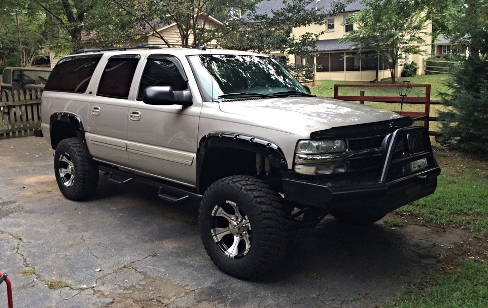

Thanks so much bud. I picked up this suburban a few months back from my brother, who owned it since new and took great care of it.
With 226K on the clock and it riding on 35s with 456 gears she drinks a little gas, and oil, but she runs like a top.
Cheers!
