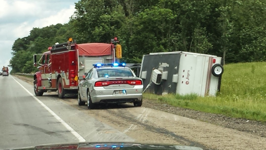

CoasterCOG Posted July 8, 2014 Posted July 8, 2014 How much do you plan to load in the camper? Are you going to fill the water tank ahead of time? (several hundred pounds right there) Dry weight is just that. no battery, no propane, no water, no gear. Max trailer weight is the better number to go by with campers rather than dry since you'll end up MUCH closer to that. There are lots of campers looking for a home, personally I'd keep shopping. If you decide that you're willing to bet that GMs numbers are BS I'd make very sure that the trailers brakes are in great shape and the controller is setup correctly. Merges are probably going to be ugly, make sure you have towing mirrors that you can see around the camper with. This pic is from last Friday. Not sure of the exact size of the trailer but I can guarantee he was over the tow rating for the X-Terra (5K) by the time everything was loaded. He ended up hitting the car in front of him, jack-knifing the trailer, and rolling it. Imagine how much fun his weekend was.
SierraPhoto Posted July 8, 2014 Author Posted July 8, 2014 Why would anyone travel with water in the tanks? Especially when their are hookups and nearly any campground you're going to stay out??? And thanks for the pic, but it doesn't scare me. He could have been texting for all we know.
CoasterCOG Posted July 9, 2014 Posted July 9, 2014 There are lots of nice places without water, electric, sewer, wifi... The guy in the picture could also have been diligent, paying attention, and thought it was just a short trip. Seems like you've had your mind made up from the beginning though and are just looking for people to chime in that it'll be fine. It probably will be.
