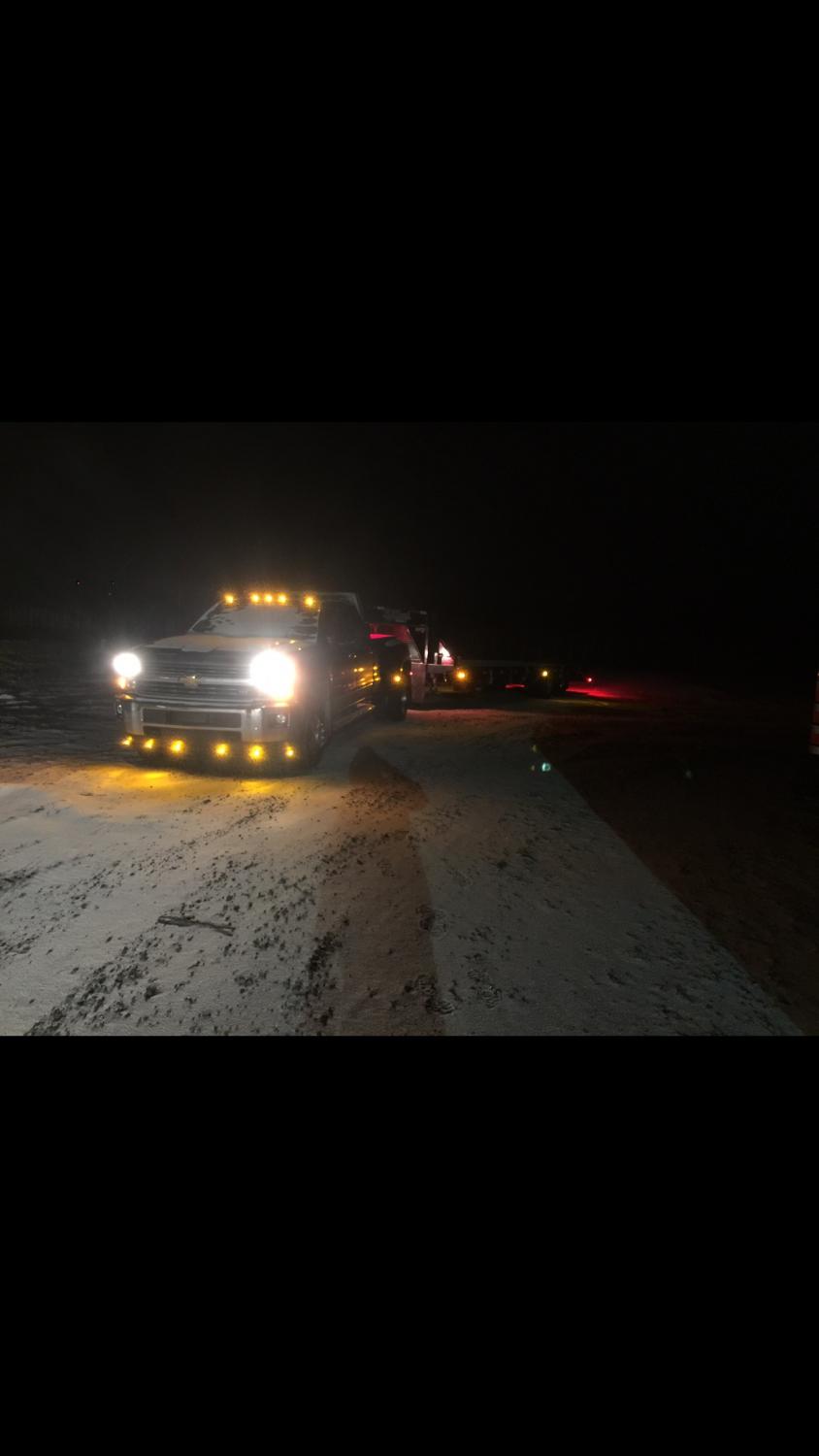

Hey guys
I got my mirriors and I have installed then as running \ Flashers
I have made a video that's kind of step by step that I will be posting to YouTube for everyone to see how to do this install
it's quite straight foward but requires patience
