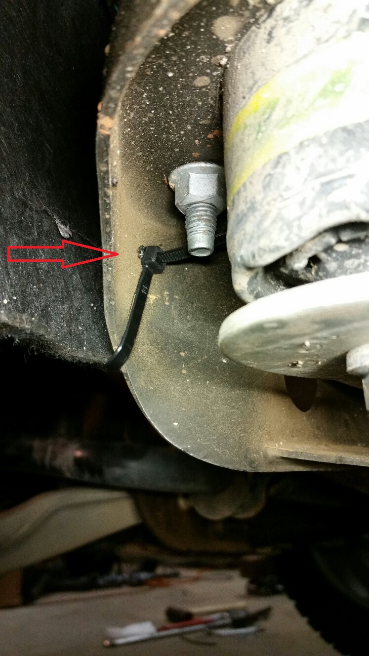

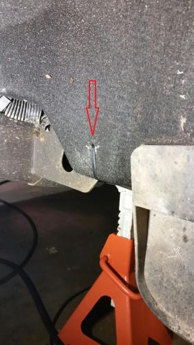

As for the level, I did put a 2" lift spacer under the front struts. It's just enough to clear everything with a stock 20" rim, with just minor rubbing of the "felt" covered wheelwell liner. I fixed the rubbing by drilling a hole in that area, through both the liner and the frame bracket behind it, and then used a zip-tie to pull the wheelwell liner back about 1". (see photos) It was enough to fit a 34" tire !
The zip-tie was a quickie job where I wanted to get it pulled out of the way to keep it from rubbing. When I get a chance, I'll get a decent looking bolt and large washer, and upgrade it from my zip-tie.

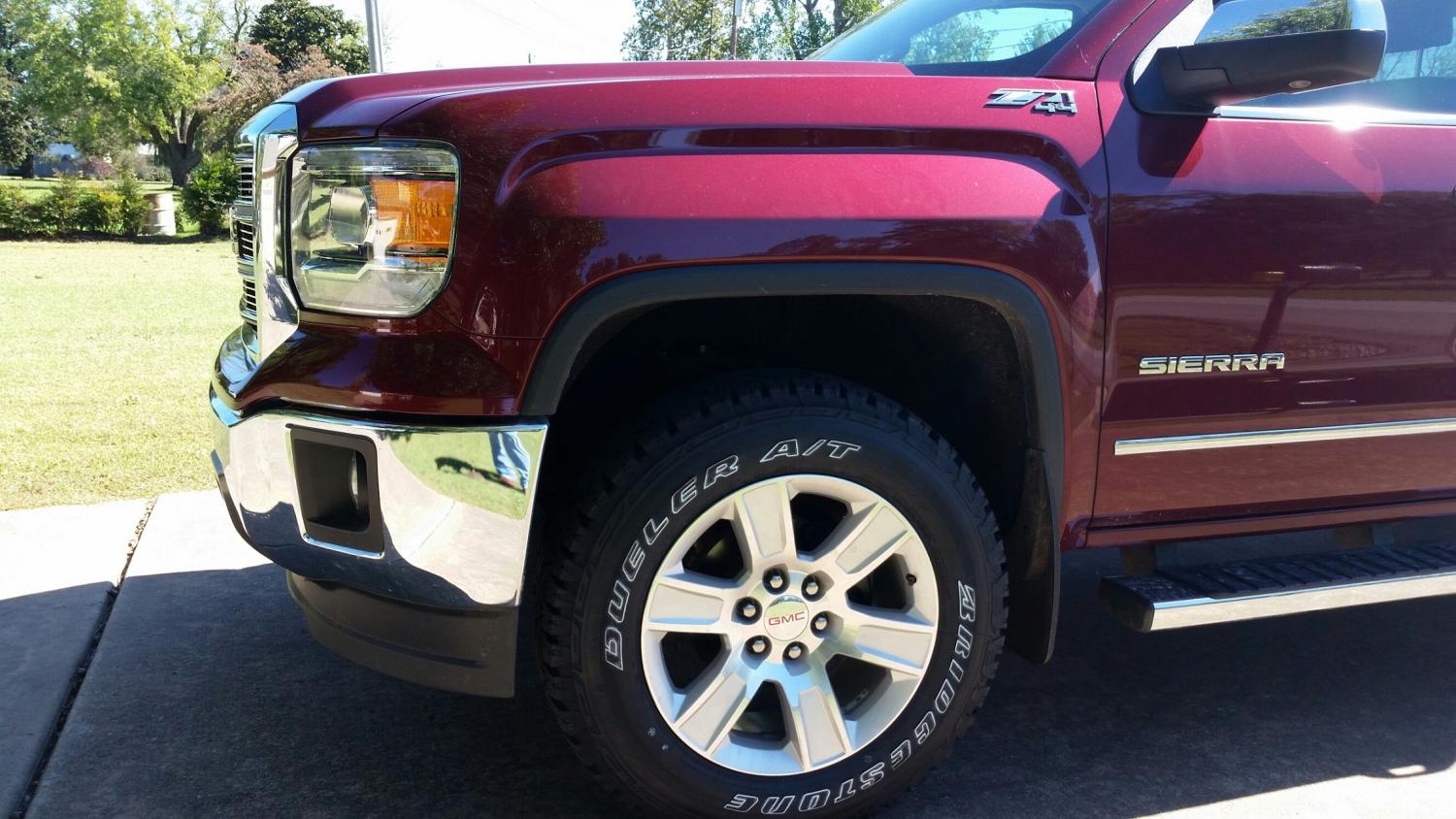

Been wanting to wash the truck to get a nice pix to post but been busy. Here's the one I took right after getting the new tires the other day. They are Bridgestone Dueler A/T's in LT275-65-20 and with the 2" lift up front.
