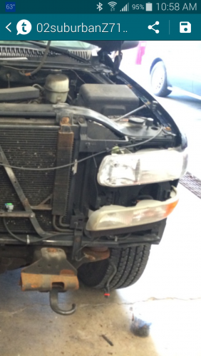

I know the power steering cooler is in the grille and i dont have that. I have no ps cooler but i would like to get the factory setup for a 06 suburban z71 which looks like this 41c96ed2ff4a908c20f93c2ee56bbf2e.jpg
If the posted pic is yours, the power steering cooler is there
Its not mine. This is an 05 but this is the setup i want. How can i add this power steering cooler?
All you have to do is just put that same cooler in the pic there in series with the RETURN line to the p/s pump. Hardest part would just be finding a suitable location for it, and drilling a couple holes to mount it.
