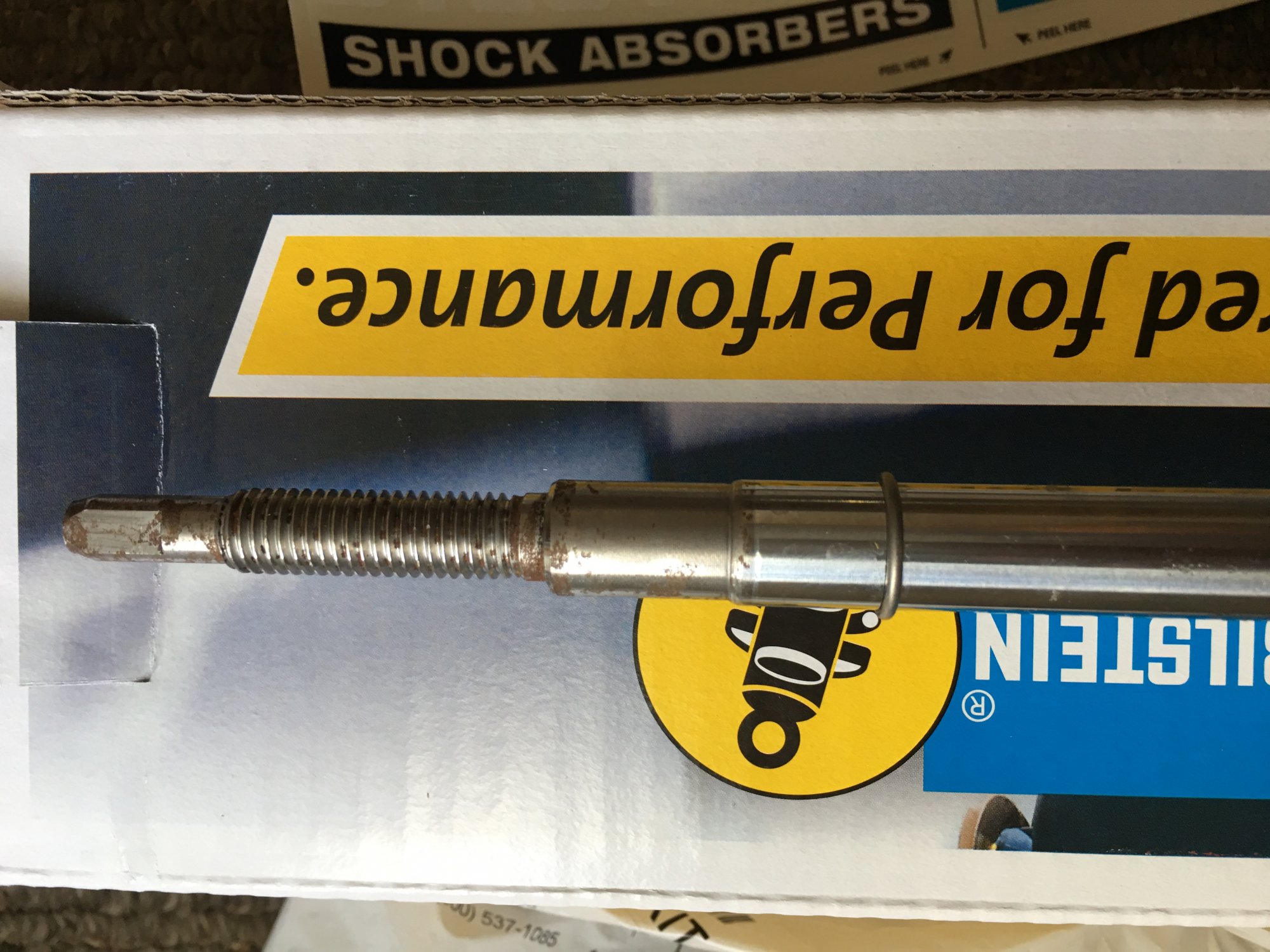

Hey all. Received my 5100’s and they have surface rust on threaded part. Polished Shaft looks fine.

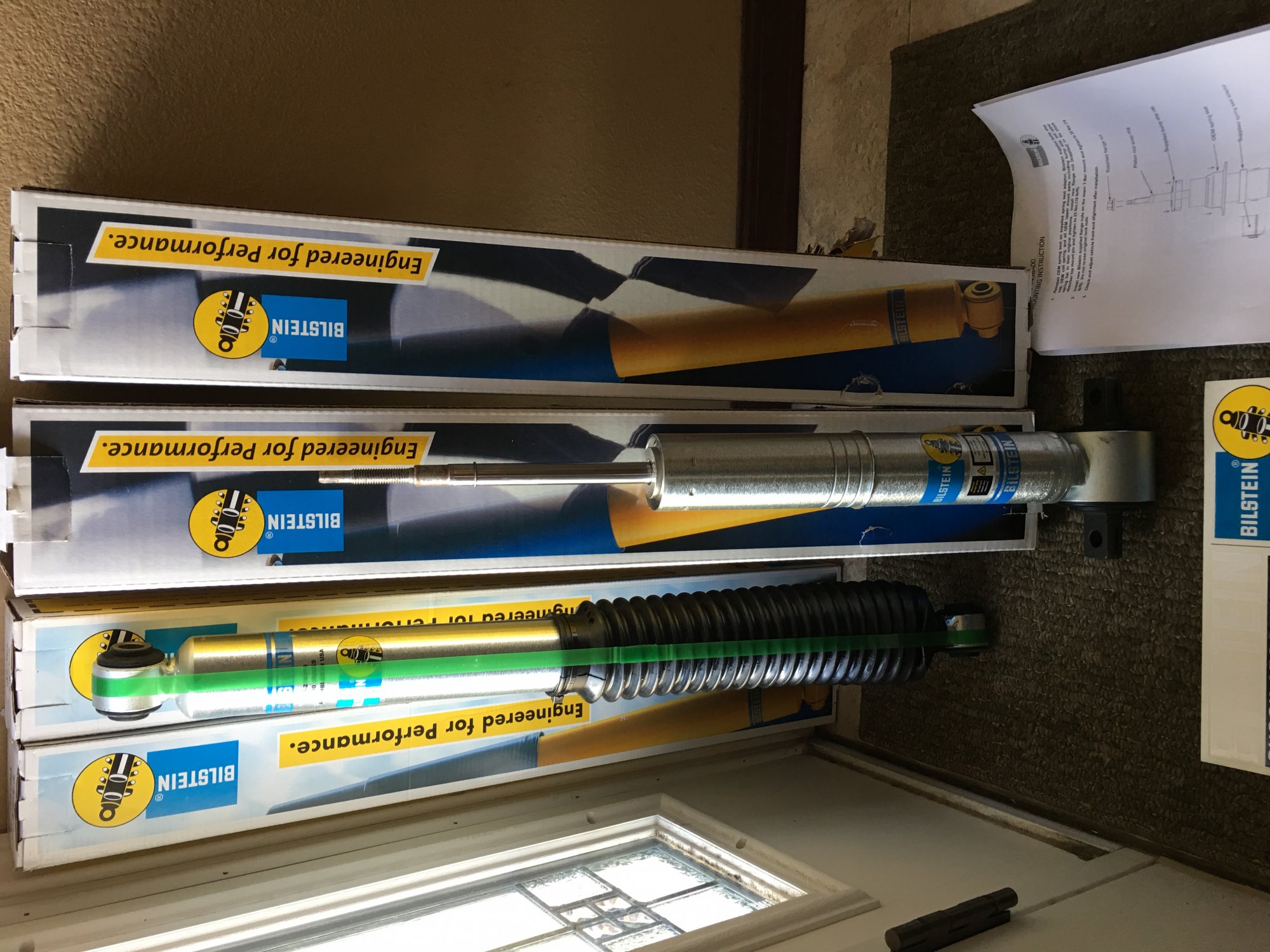

Measured 4.25” of stroke for front.
Measured 11” of stroke for rear.

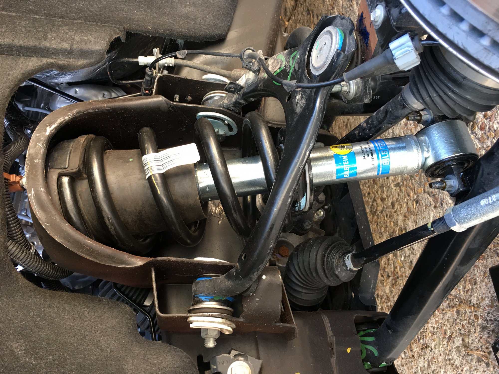

Fronts were a lot of work!
I put the ring on 3rd from bottom or 2nd from top. Got exactly 1.5” out of front. I now have a 1.25” - 1.5” of rake front to rear. Measuring from center of wheel to middle of fender. I’m happy with that since when I hookup trailer and throw camping gear in bed I will be level or slightly less vs nose high. I didn’t want to add a larger rear block and longer ubolts in rear. Rear stock height with 5100s.
Purchased a $30 after coupon strut compressor from harbor freight. Worked fine. Always kinda nervous compressing springs especially since the safety pins wouldn’t work since springs are so large. I just took my time and made sure all looked square when compressing.
Hardest part was was installing the entire assembly in truck. Only had to disconnect sway bar link. Everything was really tight and ended up putting jack and wood under strut to get it above lower control arm.
Hear some bang bang rattle rattle on first test drive. Checked the middle strut bolt and had to tighten it a lot after truck was on ground. Talk about a PITA to tighten. I used the supplied nuts from bilstein but they must be anti back-out or something because very hard to turn. No I wasn’t cross threading. Tried using some thread lube. Didn’t seem to help.

I clear coated bilsteins before install to try and keep the shiny silvery finish from rusting.

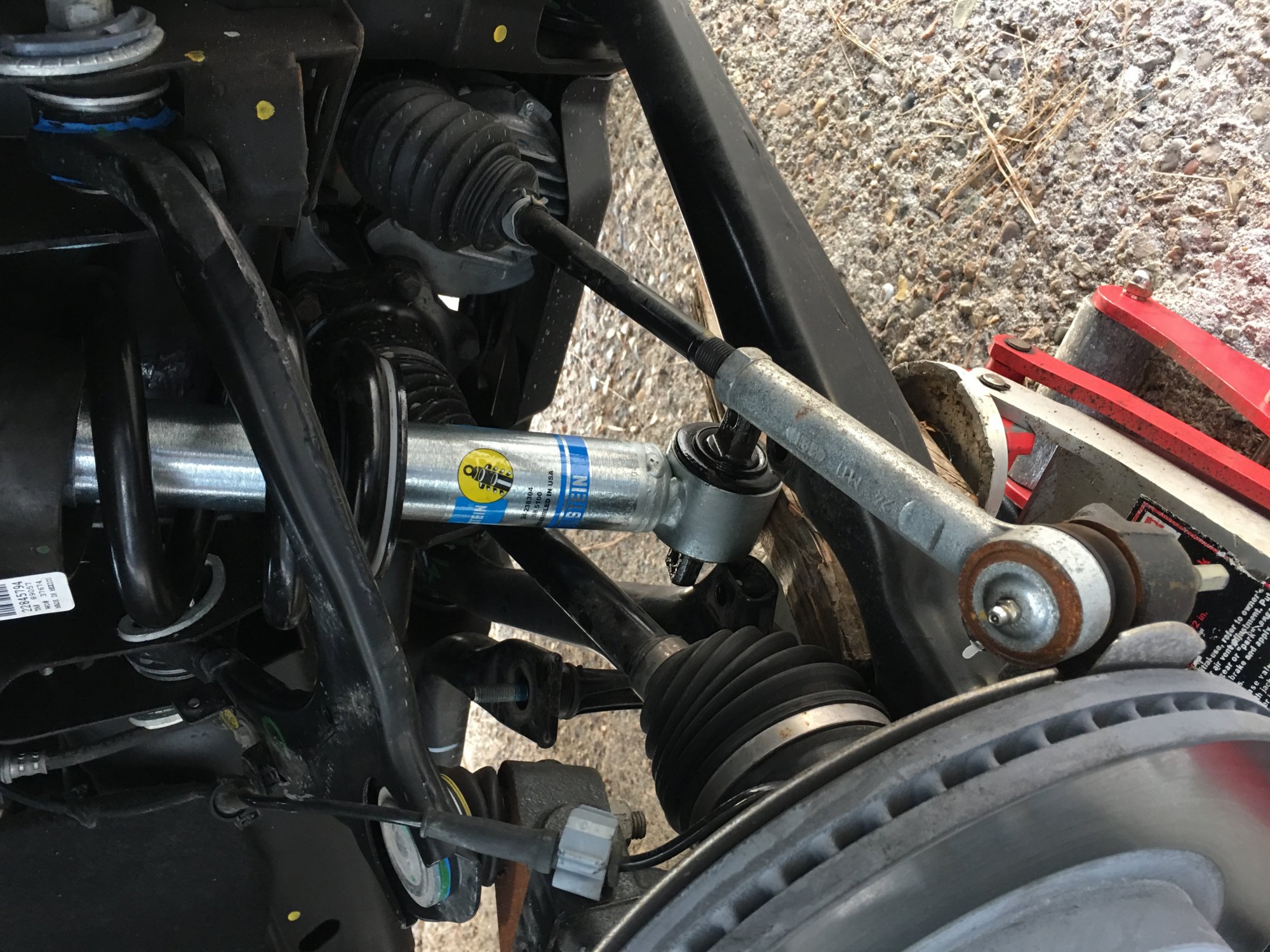

Unloaded (on jack stands) notice how upper arm is on rubber bump stops.

I  almost tore the front apart again before alignment but I’m only 1/2” from max lift and if you look at stock upper a arm it’s almost at max downtravel now. Raising to top notch would have you nearly topped out on up travel.

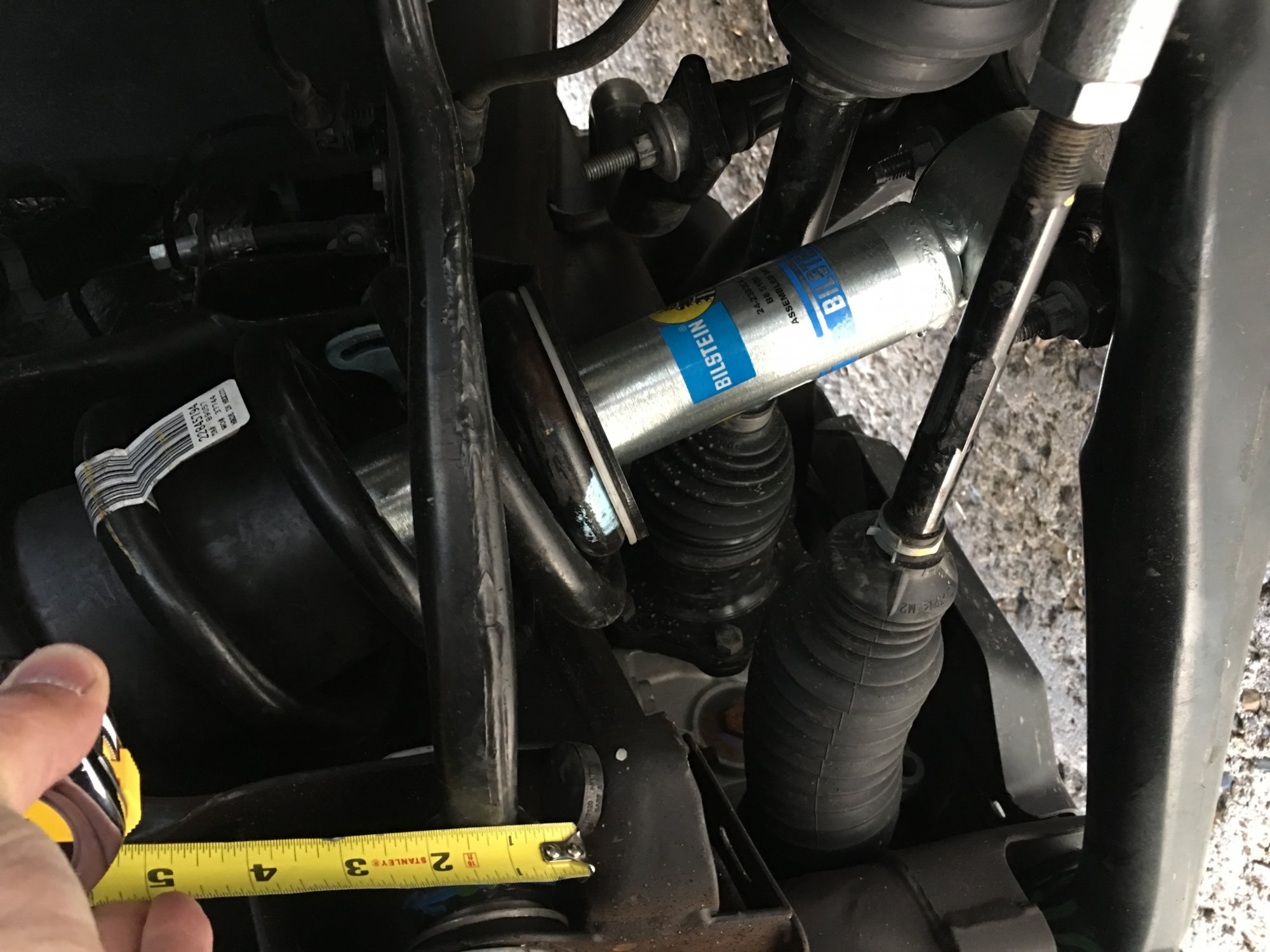

With truck on ground I have 3/4” between bottom of upper a arm to top of rubber stop.
