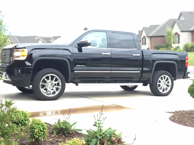

Leveled with 305/50R20's
Rough country 2.5"? What type of tires are you running?
Also any idea what your fender to ground measurements are?
Thanks, truck looks great!
Yes the RC 2.5. I believe it was ground to center of wheel well 41..... it was 39 prior to tires but I can measure tonight if you need it. I am running the 295/55/20 Toyo Open Country Mud Terrain. At first I didn't like the noise. Only because coming from a quite truck it was a huge change. However, the look and the need is why I got them. My buddy has the Toyo at2 and in the snow last week he was sliding all over. My mts hooked up and never hesitated.[emoji106] [emoji106] [emoji106] [emoji106]

Yah if you wouldn't mind getting a front & back measurement that would be great. I was set on going with the 2.5" up front then swapping the block in the back to keep 0.5-1" of rake but I don't want it any higher than that. Pictures are very misleading depending on the angle it was taken. Toyo MT's are definitely a great tire in the mud and snow, but I know a few people with them and they're just too loud for me. Also pretty horrible in the winter on hard packed ice. My truck see's 95% highway so I'm sticking with the All Terrains.

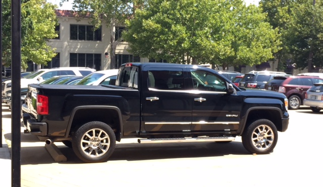

running 295/55 also.
855C9A79-7764-4B5A-8672-CFD027C3A982_zps
You also just running the 2.5" up front?, if you could get me the same measurements that would be awesome to compare. I'll be running the same factory wheels as you, any rubbing on the sway bar at full lock?

RC 2" front only. 39" front 40" in rear
no rubbing
Thanks! Crazy how there's so much variations between trucks... I've strictly asked crew cab short boxes because I know different cab/box lengths will vary heights.
In theory if you went with the 2.5 RC kit, you'd be 39.5/40 which is ideal... but some people end up nose high with stock blocks.

39 n 1/2 up front and 40 in the rear.
