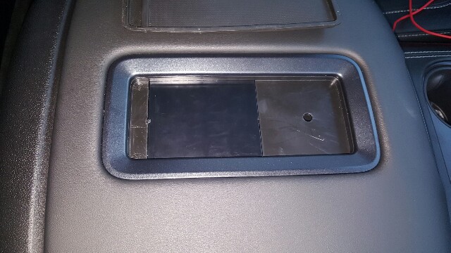

Hi everyone. I'm new to the forum but I was hoping someone might be able to help me out. I was wondering if anyone had opened up a 2015 Yukons center console lid. I have the oem wireless charging parts and would like to install them. I posted images of what I'm working with. There are no screws to be seen and I can't seem to pop any pieces off without them bending like they will break. Any assistance would be greatly appreciated.

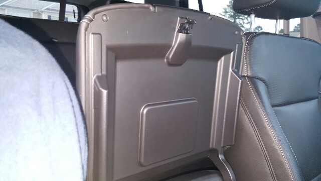

If it is similar to the 40/20/40 bench seat setup, the plastic does just pop off giving access to the screws. I took my lid off to do the dremel work.
Thank you. I will try to pry at it again. I was using a flat head screwdriver and tried in several areas but the plastic was bending like it would break. I will give it another go. I really appreciate the response.

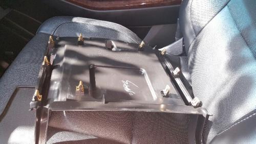

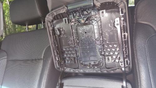

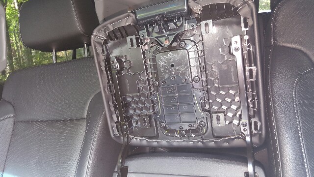

Looks like I was going about it all wrong. I was trying to go in thru the top instead the bottom pops off. I posted pics in case it can help someone in the future.
Sorry. I could have been clearer. That is what I did. once the bottom plastic piece was off, I unscrewed everything so I could dremel it outside of the ruck.
