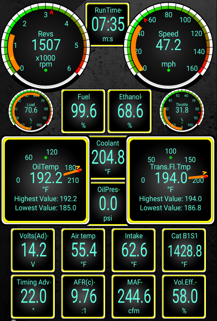

Here's a couple screenshots from the app for those of you that have not seen it. I thinks its pretty neat what it can show you and keep logs of.

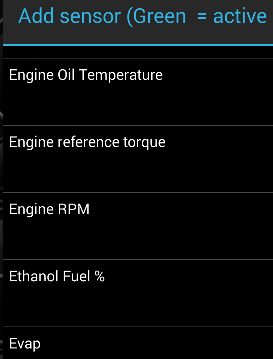

Where is the ethanol % gauge in the torque app?
See my pics. I dont recall but maybe you need to add the addition predefined set of pid's in the settings section.
what app is this?
what app is this?
Its an android app called Torque. It'll connect thru the Bluetooth on your phone to a OBDII Bluetooth adapter you plug into your trucks OBDII port.
