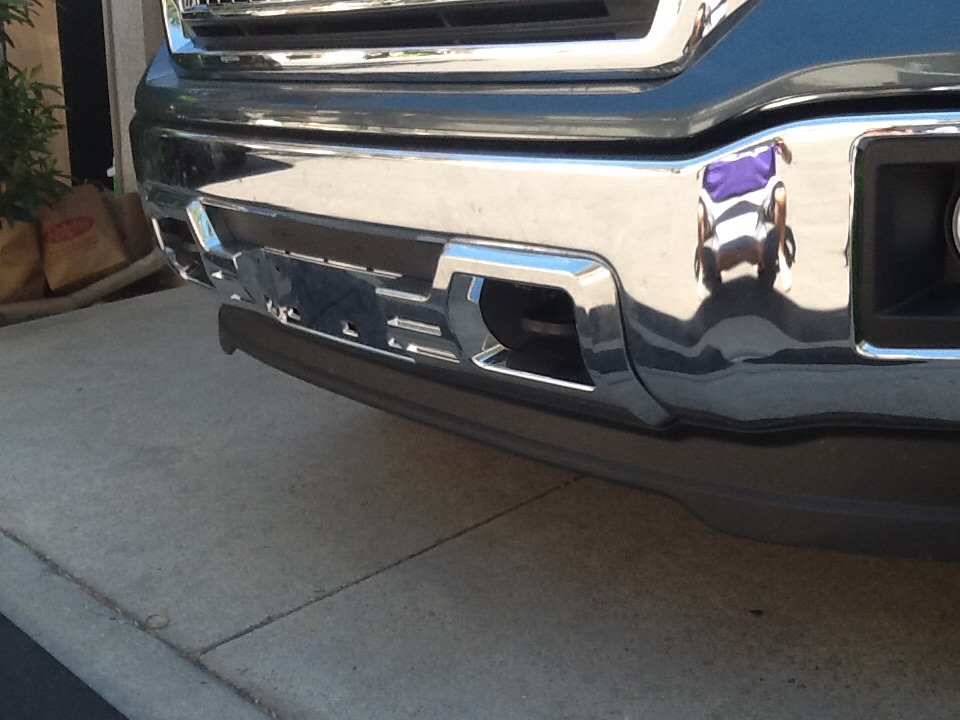

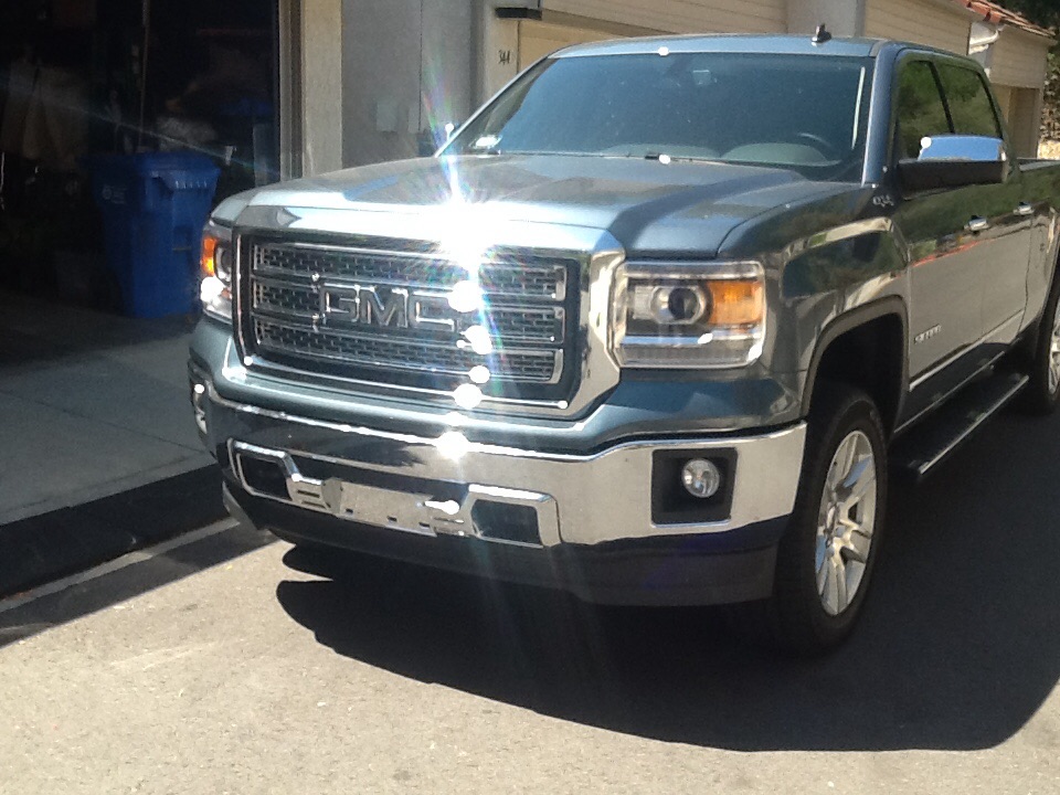

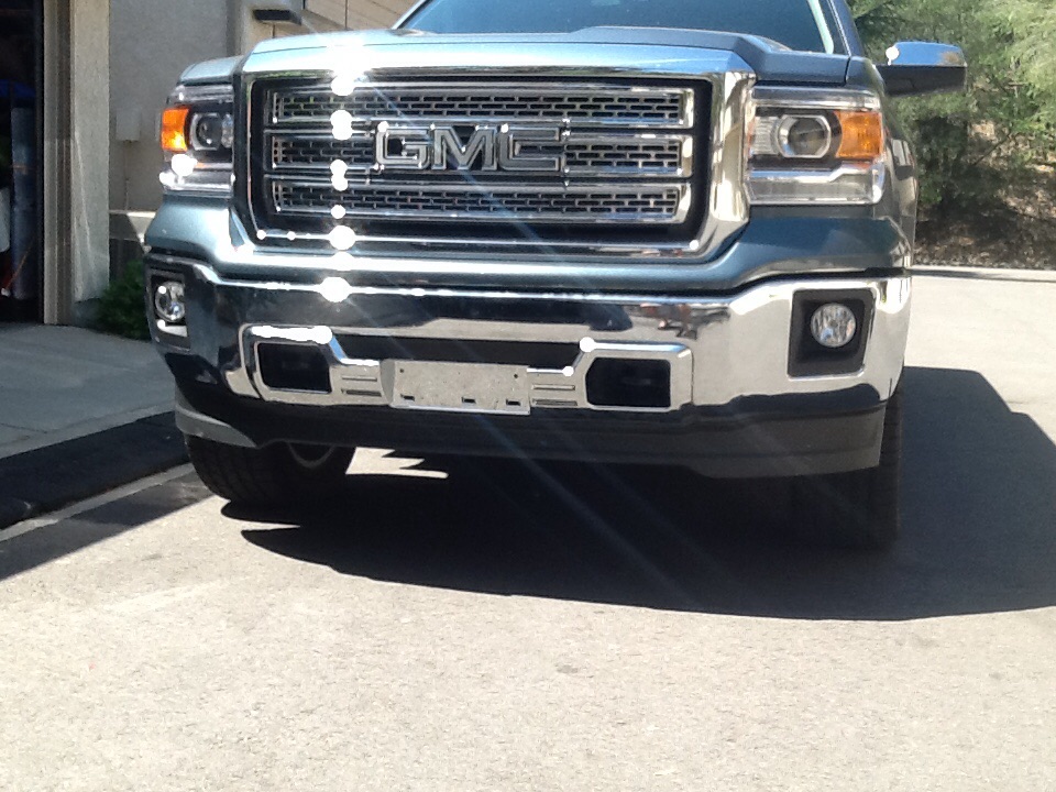

It wasn't easy as you said. But I was finally able to take it off. Damn it was hard
Here you go :) just waiting in license plate filler.
Nice!
Where did you get the chrome filler piece? Do you have the part number?
