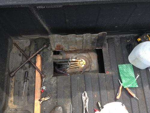

I pulled in, all normal, went to start next day..no pump.
passed relay test, jumper to fuel pump good..bad pump.
I then ordered a carter p80001S, the whole assembly. 1996-1997 only. the same pump goes all the way to a 454. I am running 5 liter. Awaiting to install. I needed an ATV lift to hold up the tank level as it drops down with 20 gallons of fuel in it. Make the job easy.

Thanks for reply, I'll just go exactly as it is, all factory. the plastic shield on tank is still there, all the bolts look easy to remove.
The problem with playing with fuel is where I am located, best get this dropped down, no games, back up and in.
The ATV stand was a comical epiphany...it is exactly perfect for the chore.

I did find an accurate template, and made a hole. no outside cord, a little generator was my best friend.
thisis only a 22 gallon tank, and guess what? it was damn near chock full. that equates to 140-160 pounds. The hole was necassary. Being this old, not sure how many times it will munch on the pump anyway. The carter p80001S is very good.

I don't know why they don't put a removable plate in from the factory. How much extra can it cost per vehicle? Even if it cost them and extra $50, raise the price of the $40k truck by $100 and make more money on it. This whole idea the bean counters have of any dollar saved per vehicle can really get to be a large amount of money. That very same logic also works when you add a dollar to every vehicle you make/sell. If they raise the price by one dollar per vehicle, and they manage to move a million vehicles, that is an easy one million dollars.
Dropping the price of a $40k vehicle by any amount of money under $500 is not even noticed by the consumer. Take a look at your bill of sale and make note of all the add-on fees they get you for. I begrudge every one of those fees, but, if there was a $500 fee for "adding various access panels to make servicing easier" I would pay it every time.
A drain plug in the bottom of the tank would be handy as well. And while we are at it, put one in transmission pans, torque convertors, manual transmissions, transfer cases, and diff covers. Wonder how much environment damage occurs in one year from all the spilled oils from having these various items serviced or rebuilt.
