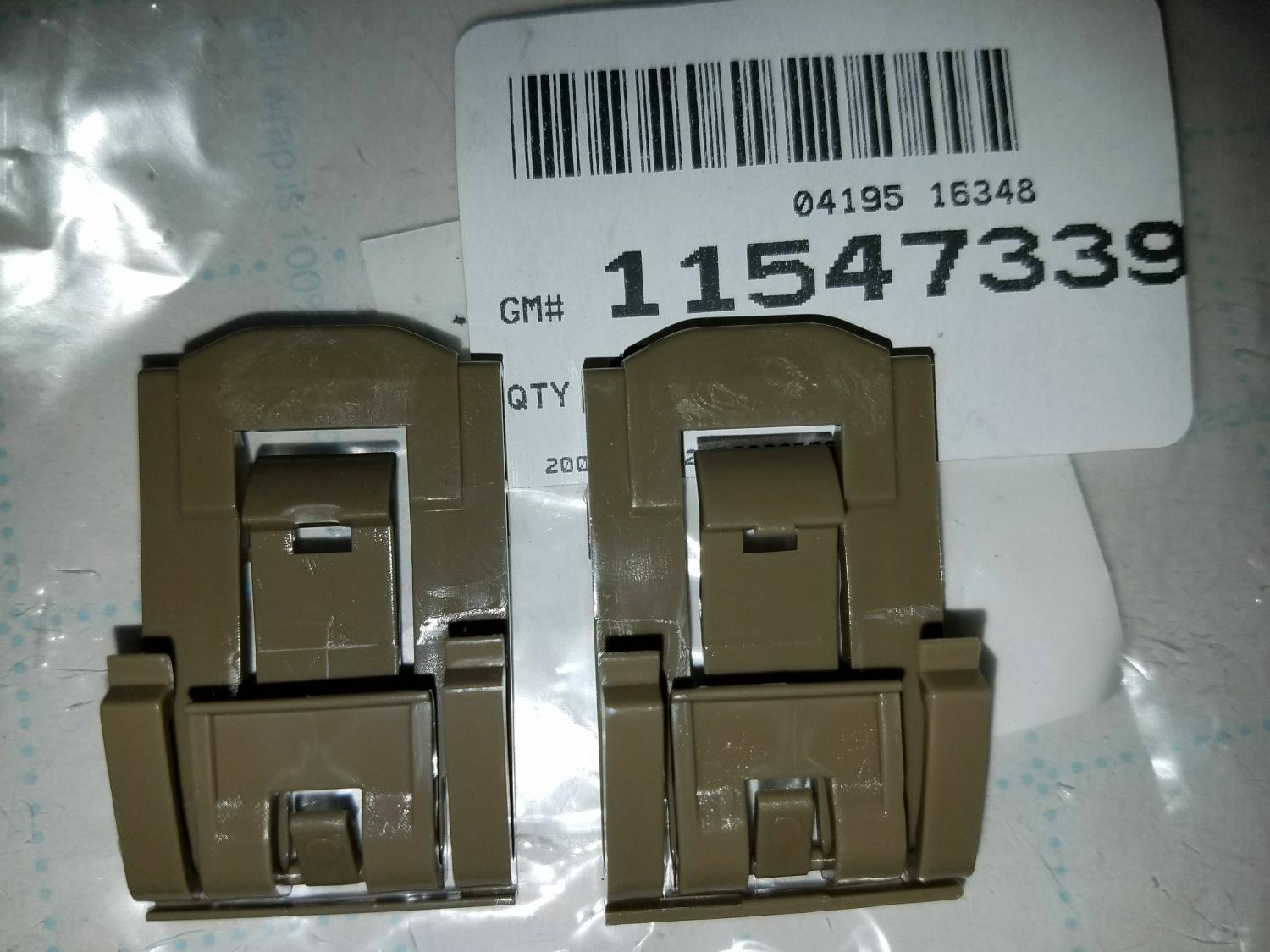

I responded in your other thread. The clips have small "lips" inside the center of them that are probably broken. You can see pictures and get the part number for new clips if you search these forums (I don't have the link handy).

You have to look close to see it. There is supposed to be a small lip in the center of the main clip (kind of like a smaller second clip). When they break off you can hardly tell they are missing but the trim will not snap down into place without these extra lips. That's why your new trim stayed in place.
