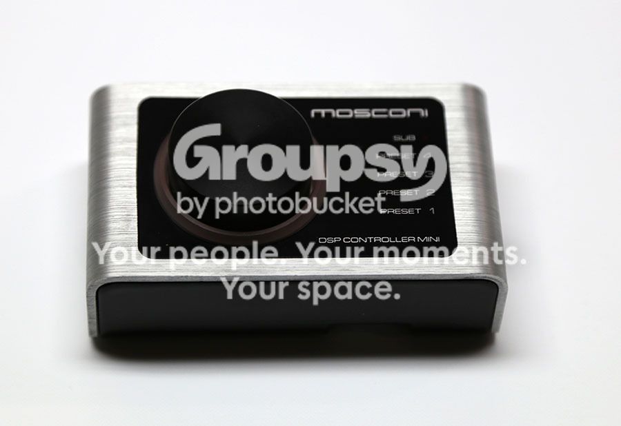

Door Panel Teaser & Mosconi Controller build in progress.
Stay tuned, it has only begun.............
