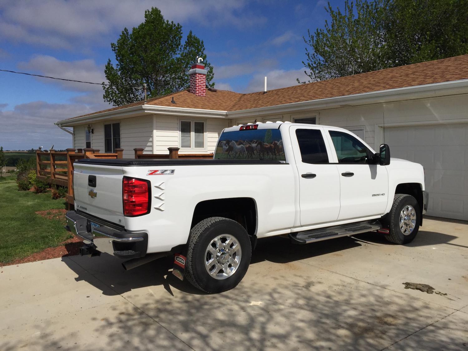

This is my 2500 with the 2" McGaughy lowering shackles on. Still a modest amount of rake, but the feline aspect is gone. It takes quite a bit of weight to really squish the suspension down. I can throw in several 55 drums of oil and hardly affect the tilt. And this beat up, old Cavalry soldier has no problem climbing in the back now! :lol:
