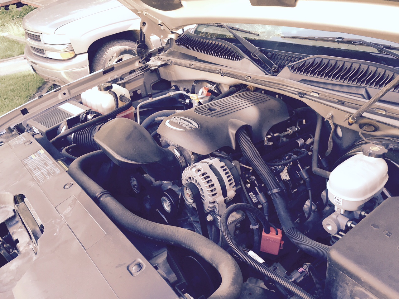

Update. I went and looked at this truck and my god is this thing clean. It's 10 years old but looks like it's maybe a year old. The bed has never been used. Look under the hood and you can tell it's never seen a northern winter same with the under carriage. Interior as well. I am picking it up tomorrow and will post some good pics for you guys you will be amazed. It had a couple issues, the 4X4 low wasn't working and the climate control wouldn't switching from defrost but they already fixed those issues yesterday after I put some money down on it. I drove it and it was straight, tight, and brakes worked perfect with no pulling or noises. This truck has the heated leather with memory driver seat and power passenger seat. Digital auto climate control, bose stereo. Pretty much has every option you could get for that year except for moonroof. I got it for $16,400.00 That is pretty close to top clean retail value on NADA but as far as that goes this truck is as nice as your going to get for a truck this age. It also has good A/T tires on it which is a nice bonus

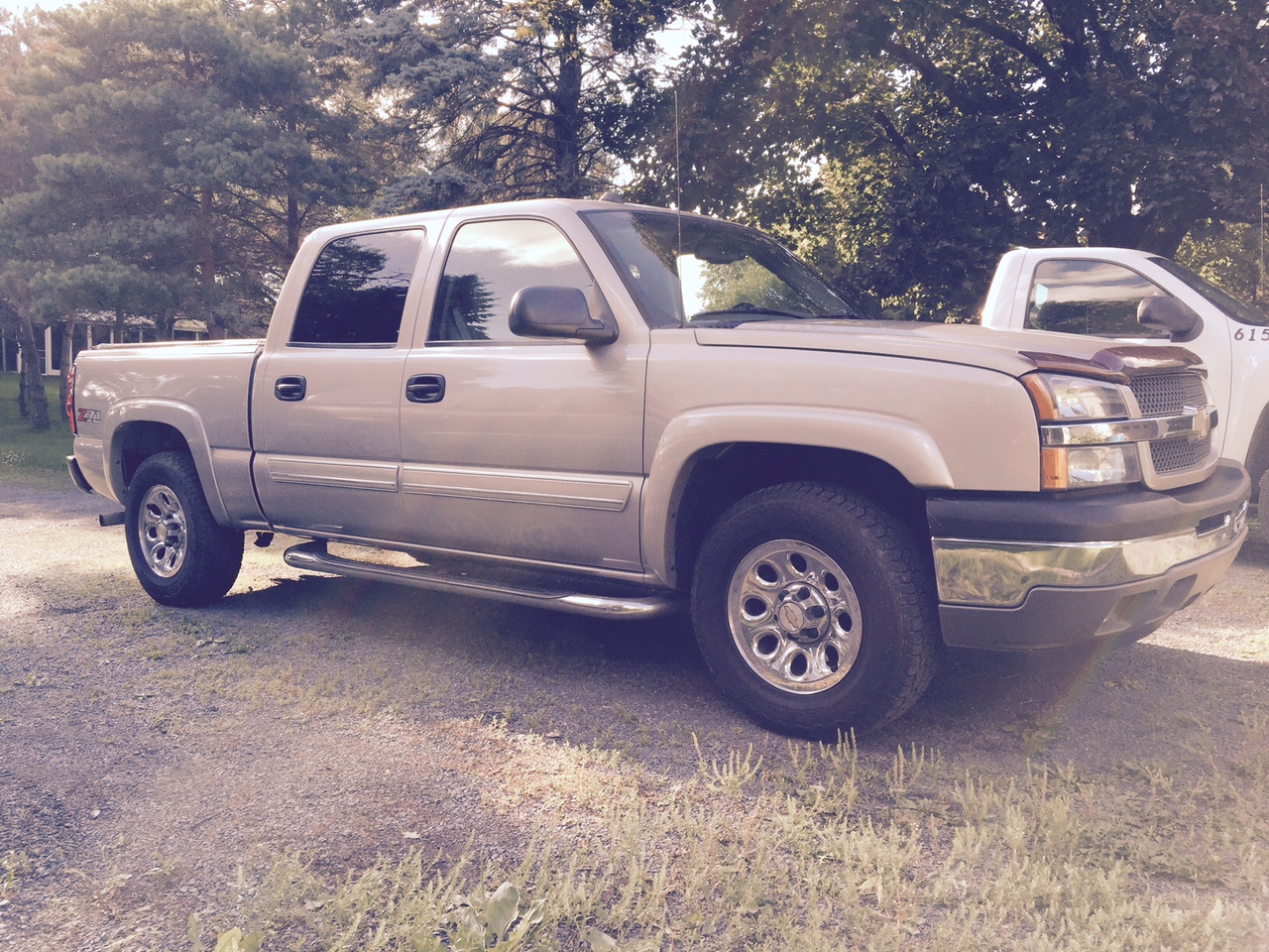

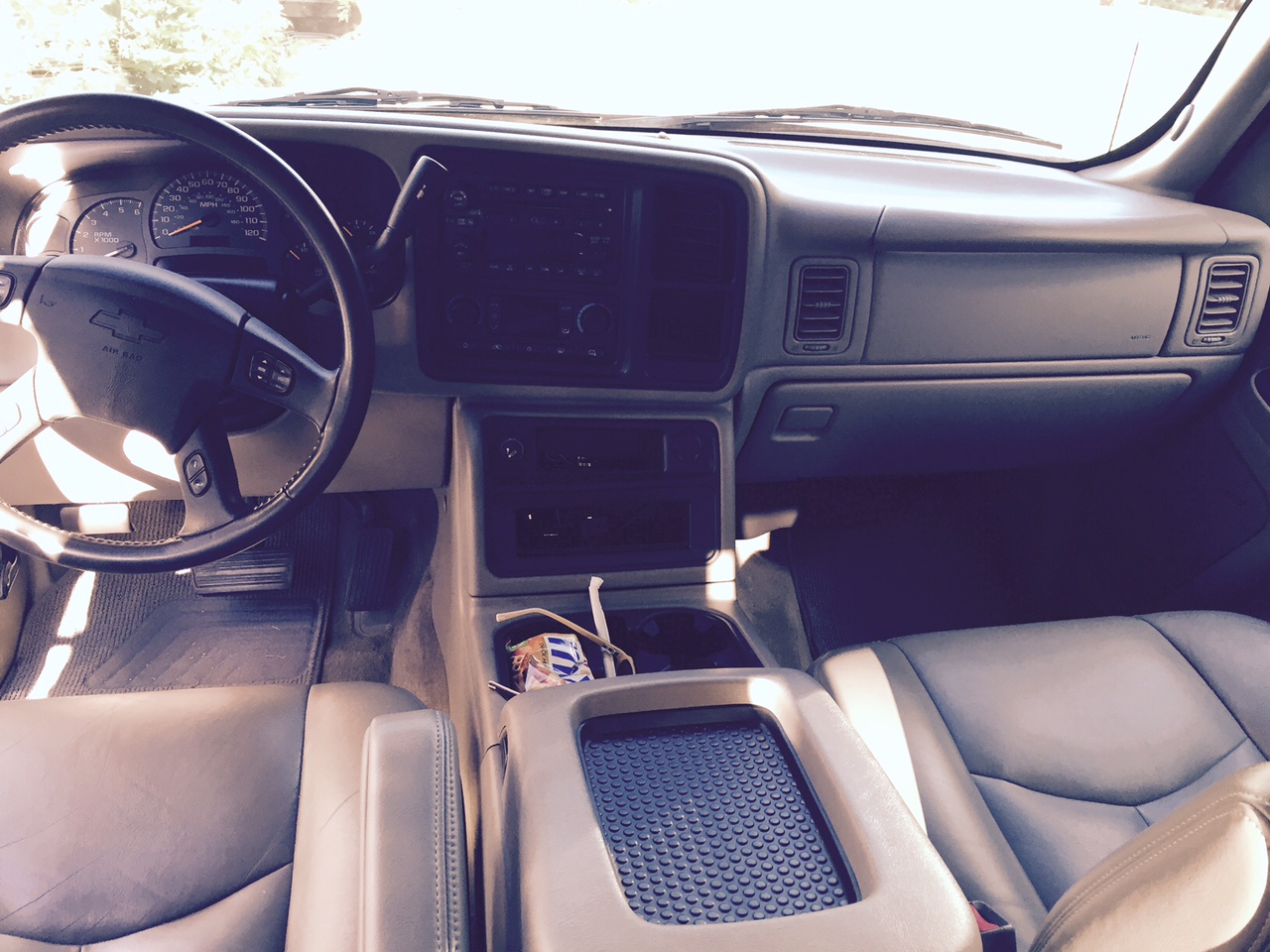

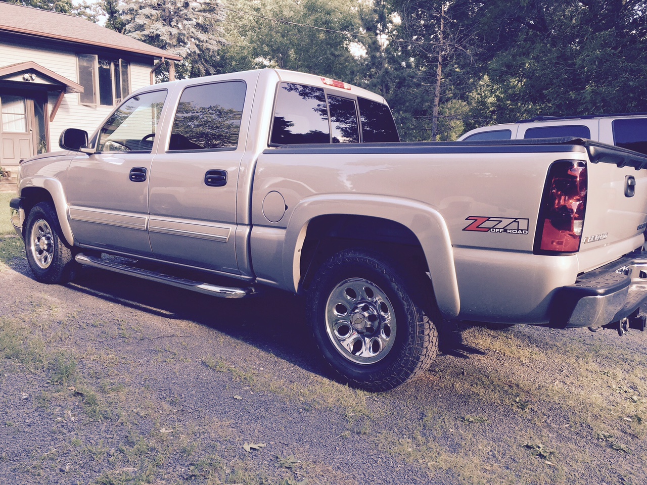

Here is a pic of the truck, I wasn't able to attach more than one picture for some reason. It kept saying the file was too big. I checked some of the RPO codes and it has the trailer tow package, 4.10 gears and LSD. Couldn't be happier
It's looks very clean!
If it has code G80 it has a locker.
It does have the G80 code. Thanks it is crazy how clean it is. You wouldn't think it was more than a couple years old. couple more pics
