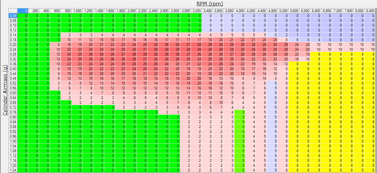

I also kill the cam retard under 3000 RPMs that is programmed in the stock tune and it feels more torquey and I have yet to lose any mileage. In fact, I kill AFM/DoD and low end cam retard and still get 20 mpg on the highway.
Higgs, my understanding was the VVT advances the cam at lower RPM for higher BMEP, by closing the intake valve earlier, and retards the cam for higher RPM produce more peak power.
This is true at full throttle but there are separate maps/tables for part throttle. It's programmed to severely (like 20-30 degrees in some places) retard the cam in the cruising/light accel ranges for an EGR effect for fuel mileage.
I kill that, lose no mileage, and pick up part throttle response/torque.
Just FYI, it doesn't change the intake cam, it moves the whole cam. LSA is fixed just like on non-variable cams, it retards intake/exhaust together. No separate adjustment for intake and/or exhaust.
I knew it rotated the entire cam, I just wasn't aware there was a mid-range schedule.
