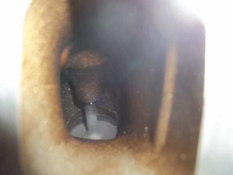

I swapped intakes this morning and it was very easy and straight forward and only took 1 hr 5 minutes start to finish. Gains.... none that I noticed just a more pronounced sound from the Airaid MIT. I did some WOT pulls from a dead stop and some Interstate WOT blast up to the speed limiter and really no difference.
Now I did take a picture of one of the ports and they all looked like the one posted and the Truck is a year old as of 7-25-14 and has less than 4000 miles on the clock with a RX catch can and clean side separator. I'm sure the Headers, LT-1 Cam and 93 octane Tune will bring everything together were it should be.
