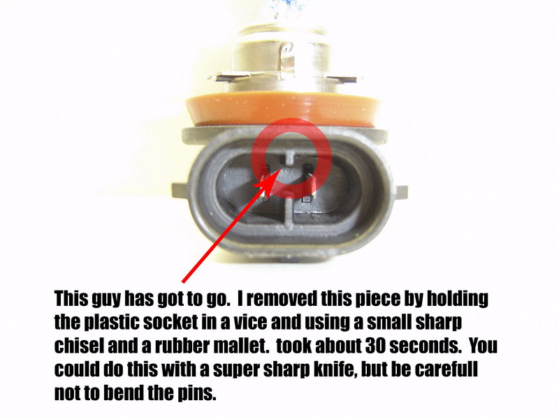

Does the H9 need any modification?

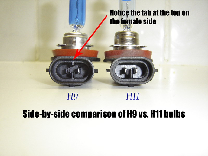

What is the advantage of the H9 over the H11? More output, better options, etc?
I think the H9 is a high beam bulb in the low beam socket.
Correct. H9 is the high beam equivalent of an H11. It has no built in glare cap, but that doesn't matter as our headlamps have a built-in glare cap. You get considerably more light with the same sharp cutoff.
