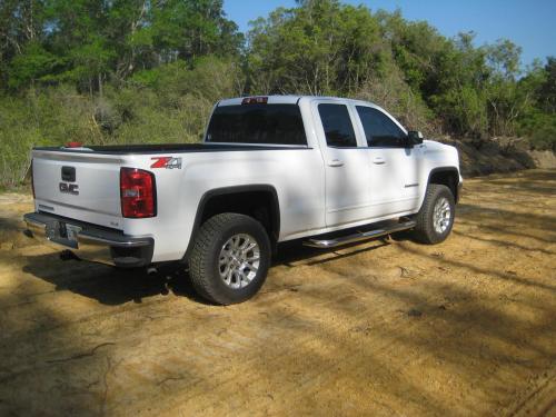

Anyone have pics of the stock 18's with the +1 size tires? Looking like I want to go with a 275/65R18 on the factory 18's which I love. OE 18's are 18x8.5. Just wondering if anyone has pics or has done this...
I has nittos in that size on my 14. Worked well. Looked good. I'll try to get a pic later.
I have Cooper pics in this size in my build thread.

2014 DC with RC 2.5 and Nitto TG G2 275/65r18 (not LT). Leveled, removal of front air dam, and larger tires has my mileage around 17mpg at best (usually 16...was around 19 when stock with GYs . Lifetime over 10K miles is 15.5mpg, but it's reduced because I get 10mpg when I tow. Tires were put on before the level and fit fine....I think 285s might fit without a level.
Look decent when next to truck and from the front and rear because they bulge out a little. Tread width is around 10" and with the weight of the truck, they stand about 30" tall.
When you approach the truck from the side, they don't appear tall enough. 285s would look better and 295s are too big for just a level. I'm contemplating a 1.5 BL so I can go 295 next.
Non-LT Nittos don't have tall tread (aka thick rubber), so they look kinda worn even when they are new. They are warrantied to 60K, but I don't see them lasting that long. Bad on wet roads and clay.....smooth on highway with little noise.

thanks for the pics guys. ^ That's exactly the look I want. I'm pretty dead set on not running a E-rated tire. Stiffness and weight... overkill. the GY Wrangler's with Kevlar are C rated, 48 Lbs and look good and have great reviews on TR. But yes, the 275/65R18 is the way to go. Pics sold me!
