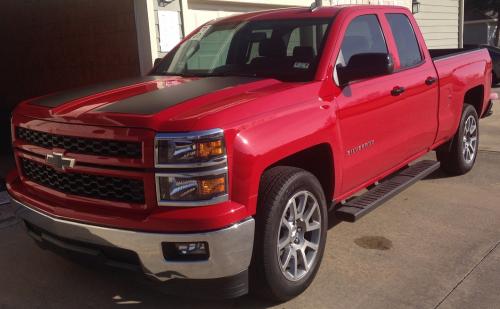

You dont want buy the textured black grille. ABS plastic frays when sanded and you have to pile on the primer to hide it which is a very bad idea and will cause the grille to chip easily. Buy the sport package grille and remove the painted outer trim and paint it to match your truck. I did that with a sport grille and a high country.

Flawless, but my grille isn't chrome. In fact it is all for sale now.
I have a chrome grille, and those grills are just like a plastic chrome over the grill, so does anyone know if you strip away that plastic chrome that is on the chrome grills if you can paint that?
Good luck getting the chrome off. It isn't going to come off like you would think. buy a sport grille that is a different color and repaint it.

Is the sport grille like the rally edition one?
The outside trim is from a sport grille. The inside is from a high country.
