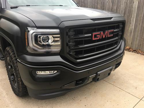

Do you know the style/name of the grill you have? the black/grey honeycomb looking part by the GMC symbol, the three rows
That is the all terrain grill. Occasionally if you get lucky you may find one on eBay in the color you want. Otherwise you can get them from your favorite GM parts supplier and it would have to be painted to match. I believe in the past GM sold them already painted but I think that is no longer the case.

I know you said no black trucks but my grille inserts were a black chrome color and I hated it!!! So I had to plasti-dip them :) Looks a lot better IMO
BEFORE
AFTER
You dont want buy the textured black grille. ABS plastic frays when sanded and you have to pile on the primer to hide it which is a very bad idea and will cause the grille to chip easily. Buy the sport package grille and remove the painted outer trim and paint it to match your truck. I did that with a sport grille and a high country.
