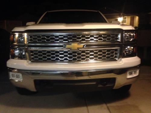

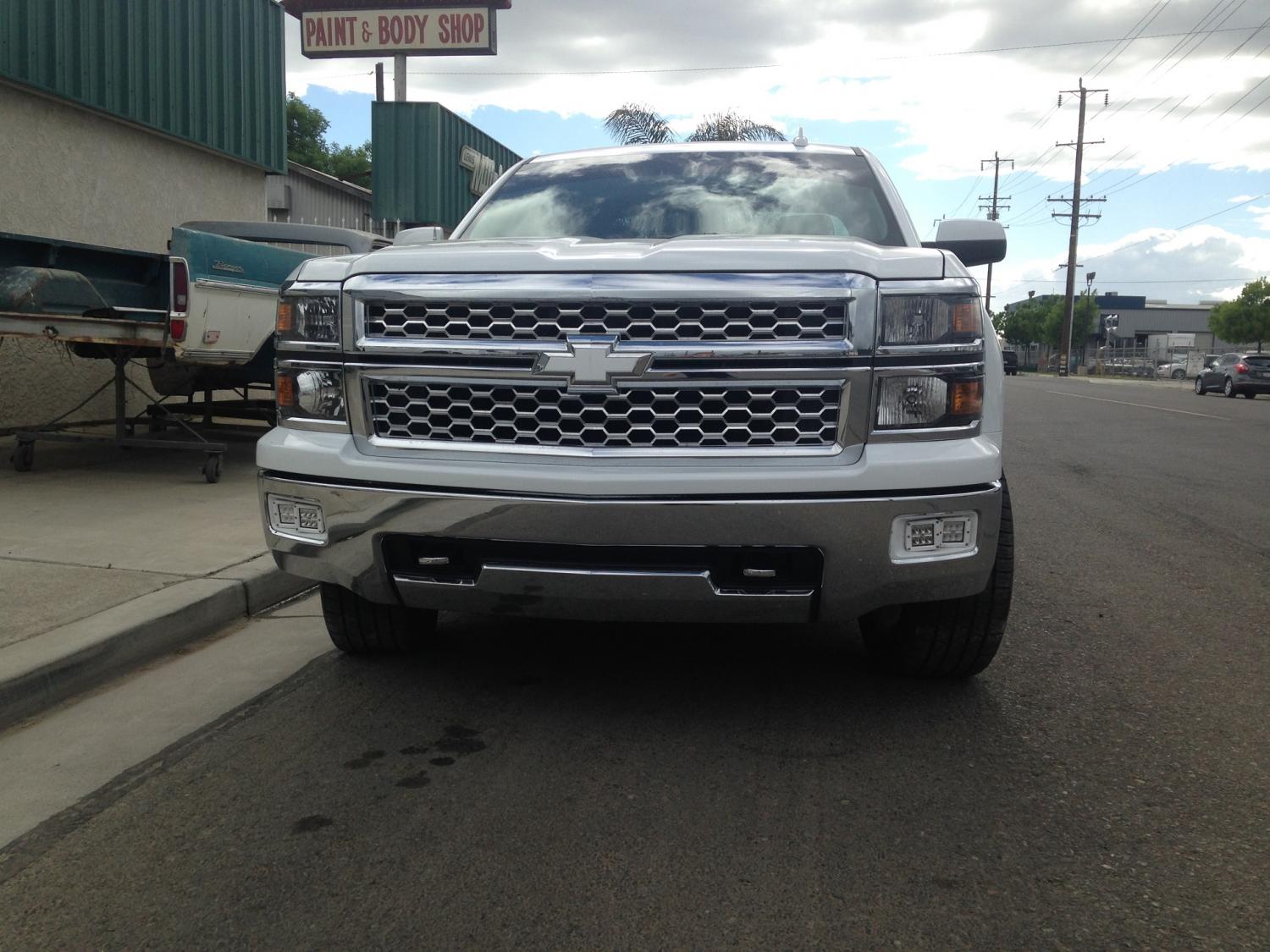

Quad LED fog lights
What housing are those?
welcome . fog lights - 4 lights to one switch or two switch's , also how was the install ? good looking truck
They are the factory LT housings, trimmed to fit the quad LED cubes and painted white to match.
Thanks! Fog lights are wired to the existing switch/wiring with adapters, so all four (two flood outside, two spot inside) wire up to the same switch. The install wasn't too difficult, but I would've been able to do it a lot faster if I was more familiar with this truck. I've since taken the front end apart and goes much quicker now. There's a write up here that is helpful, just make sure not to take the bumper mounting plates completely apart, loosen as needed, but if you do you've got a bit of time wasted to get them put back together right.
http://www.gm-trucks.com/forums/topic/166644-silverado-dual-fog-light-mod/
Welcome to the group, beautiful truck!!
Thanks!

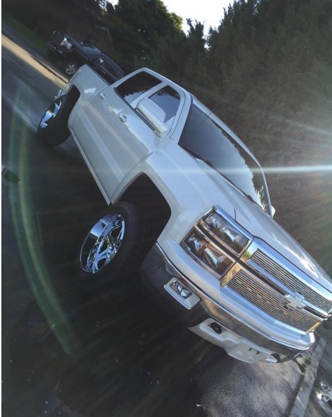

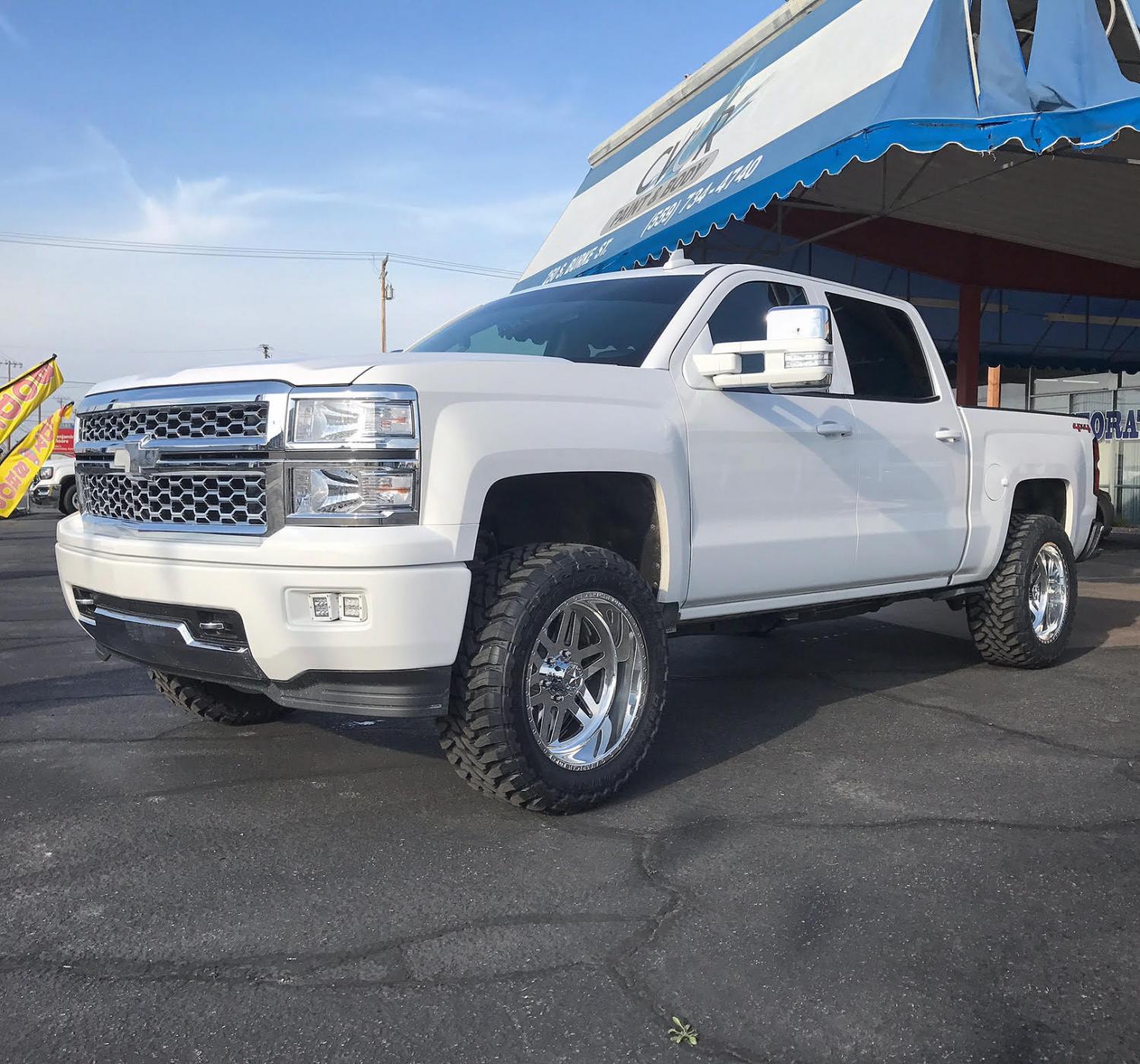

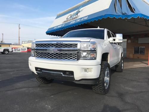

Some updates to the truck...
  • 2.5in level, 1.5in Zone BL
  • 20x10 AF Liberty polished wheels
  • 33x12.5R20 Toyo Open Country MT tires
  • Painted front and back bumpers
  • billet bowtie grille emblem
  • cleared headlights
  • PTM tow mirrors w/clear marker lights
These ones do not...they make ones that do, but you need an additional harness and need to reprogram the computer since I have an LT and the powerfold is stock on LTZ's. I was originally going to but all that effort plus cutting an OEM rocker switch into the dash cleanly and $1000 extra later wasn't sure how much I'd use them...Now I'm almost wishing I did, but live and learn.
