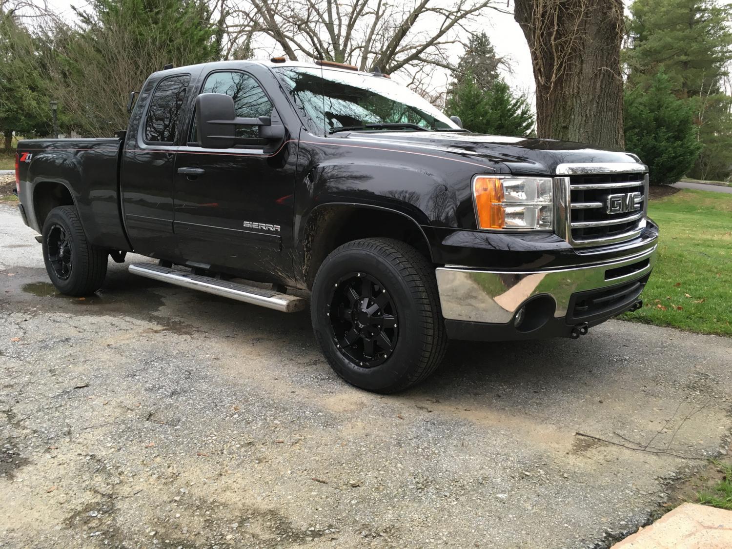

I will be bringing my truck to school (Washington D.C. area) this semester and I am a little concerned about keeping the battery from dying in the cold weather. I leave my truck in a parking garage and can really only drive it on weekends - so once a week. Is there anything I can do to prevent my battery from not having enough juice to start my truck when the temperatures get cold? Thanks for any help!!
