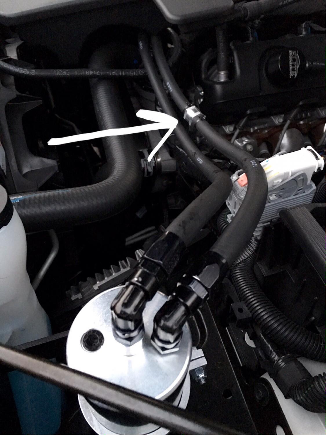

Put this on yesterday. No instructions came in the box and the website instructions were not that good. I emailed them for the placement of the check valve and they responded quickly. I called them a couple times on a couple different days and always got their answering machine. Anyways, happy with the quality of the can and the 1/4 turn ball valve makes it easy to drain.
I had to watch a video for check valve direction. How the heck did you get those rubber lines on those fittings?? They are meant for braided rubber hose, with the rubber hose not having near the wall thickness of plain rubber hose. There was no way I was going to try and force them, because that's what I would have had to do to get them on.

I used some WD-40 and it worked like a champ. No leaks yet. I need to put some zip ties on the 1/2" hose just for peace of mind. The check valve chatters at idle, but you can't hear it from inside the cab.

Thanks for that. I think I'll change mine to those when I get another decent day. They look much better too!

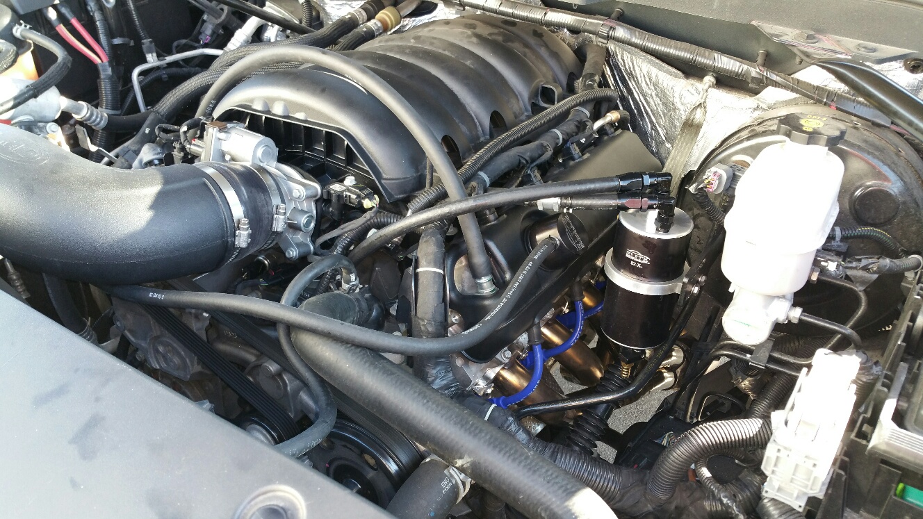

DeepSea, thanks for the pic's, this is where I am going to mount it.
The two places they show mounting the catch can are the left master cylinder mounting bolt and one of the bolts that hold the windshield washer fluid tank. Pretty much 90 degrees from where yours is mounted now, but in about the same place. On the check valve, I just blew threw it to see which direction it was made for (there is a tiny arrow on it), then the only question is which side line it gets installed in.
I'm mounting mine this weekend. I am going to try to do the master cylinder mount, but I think the bigger can is too big to install there. I also installed a barb fitting on the drain ball valve along with some clear tubing going to the bottom of the engine bay. This way I can just throw a drain pan under the truck in a predetermined spot and hit the ball valve to drain. I think we are going to have a problem holding a pan under the tight spots and trying to drain the can. I also want to use the spare battery location for a 2nd battery later.

If you are worried, just blow thru them. You will figure out which way they go. Remember the direction of the flow goes from the lower fitting on the motor thru the can and out to the higher intake manifold fitting. On the E2X can the outside fitting goes to the outlet side. In other words out to out. My biggest fear was reversing the hoses.....
