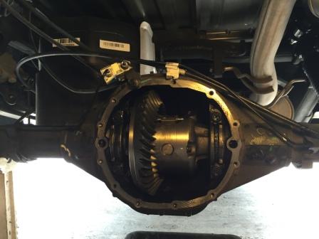

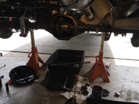

Just want to thank everyone for their input. It took me a little while to get the parts ordered and finally got a good weekend to do the install.
The swap was a great success!
A few things I wanted to point out, for anyone else.
1- the seals on the axles were really tight, I had issues trying to push them in to remove the c-clips, and the same for pulling them out of the carrier. A second person really was a big help in pushing and pulling
2- removing the ring gear from the open diff carrier was a painful and slow using a mallet to walk it down, maybe heat would have helped. Loading it back on to the new G80 was not as bad since I did heat it prior to the install
3- I had no issues with reusing the stock gasket, no leaks
