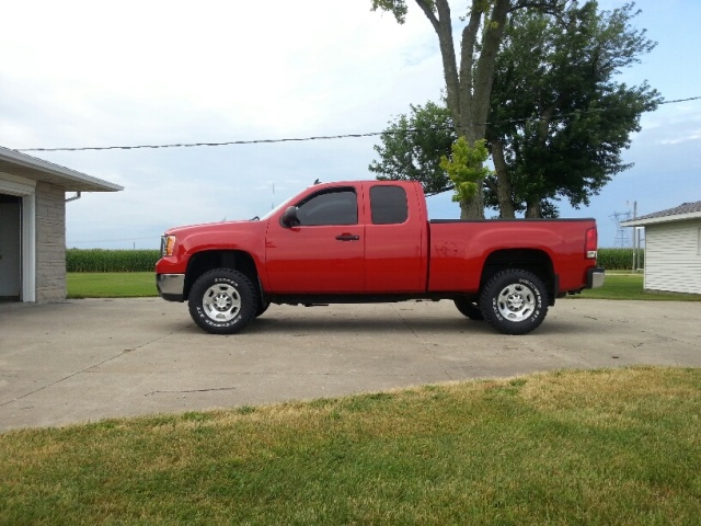

Here is a picture for reference, 285/60/20's with the torsion bars turned all the way up (no plow prep)
If you want it higher it is going to cost some money, if you can live with that height it can all be done for under $200.
The picture of that truck looks great and is exactly what I'm looking for! You mention the bars are turned up to the max In that photo...is that when the shock extensions come into play? Maxing out the torsion bars seems like it would really damage all the ride quality no? Sorry so many questions but this is helping me tremendously. That truck looks spot on what I'm going for.

No the non snow plow prep torsion bar bolts are not very long so when you "turn them all the way up" you are only turning 7-9 turns of the bolt which isn't much.
