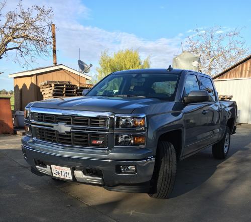

What's up guys, picked up a 15' LT Z71 w/ 5.3 back in Dec. coming from a 2005 4 runner I had a bit of a lead foot with my Chevy. So far I have done two break stands and floored it twice. Truck has plenty of balls, I just hope that I haven't messed up anything. Only 3k miles. I hear a slight clunk when going down hill off the gas when tranny downshifts. What do you guys think?
