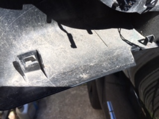

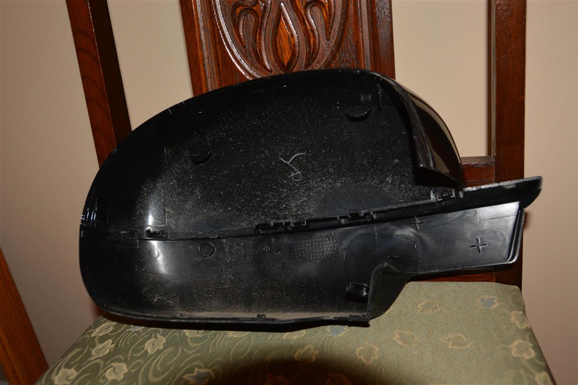

Im trying to change out my color matched mirror caps on to my new dl3 mirrors. I took off one of the chrome caps off my old mirror very carefully and it still broke the two bottom clips. Would be nice if someone that has successfully removed these caps without breaking anything would let me know how its done.

not sure if the newer mirrors are the same but on the 13 down you can take the lower black plastic piece off with the color matched piece all in one piece, then you can get it apart without breaking the clips holding the two together

no links but can show you the cover off the mirror , just go around the edge where it meets the front plastic gently wiggling and with a small tool to help it along to pry it apart
then you can separate the two parts from each other
you still have to be careful on the tabs holding the two together a little wd40 might help

So apparently they do come apart like the 07-13 mirrors. I choose to take the entire mirror apart to remove the caps without breaking the clips. Mission accomplished. I removed the glass first then the entire frame and finally the caps. You have better access to the two clips this way.

I have 2015 dl3 mirror with chrome covers and dl8 mirrors with painted covers. When I went to swap the covers the chrome covers broke and the painted covers did not. The chrome plating makes the plastic really brittle, so I doubt anyone can take them off without breaking.
