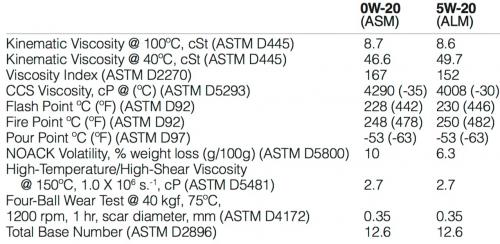

Compared to a 30w or 40w, yeah, that would be true to some extent. But a 0w20 and a 5w20 are the same viscosity at operating temperature, so there is no advantage to a 0w20. Only on cold startup, and only if you lived in Fairbanks, AK during the winter. Here is a shot of the data sheet on Amsoil 20w oils....
The NOACK (burn off vaporization rate) is significantly higher for the 0w20 than the 5w20. That is because the 0w20 oil itself needs a significant amount of viscosity improvers to meet the spread. And viscosity improvers are what shear under extreme pressure. A higher NOACK is more detrimental to intakes and valves, as there is more oil vapor from the high NOACK getting into the intake system via PCV.
But the viscosity, at both cold and engine operating temps are virtually identical. A 0w20 is not "lighter" than a 5w20. I wouldn't even consider a 0w20 over a 5w20 except in the most arctic of extreme conditions. The idea that gets thrown around about machine tolerances is a ruse used in marketing. As I stated, the viscosity of a 0w20 and 5w20 are virtually identical. And even a XXw30 oil would work fine in these engines even though GM specs a 20w primarily for CAFE economy reasons. There is no difference in machining tolerances in current production engines whether a 6.2L Ecotec which has a 20w recommendation, or a 6.0L Vortec which has a 30w recommendation or a Detroit 15L that also has a 30w recommendation.
